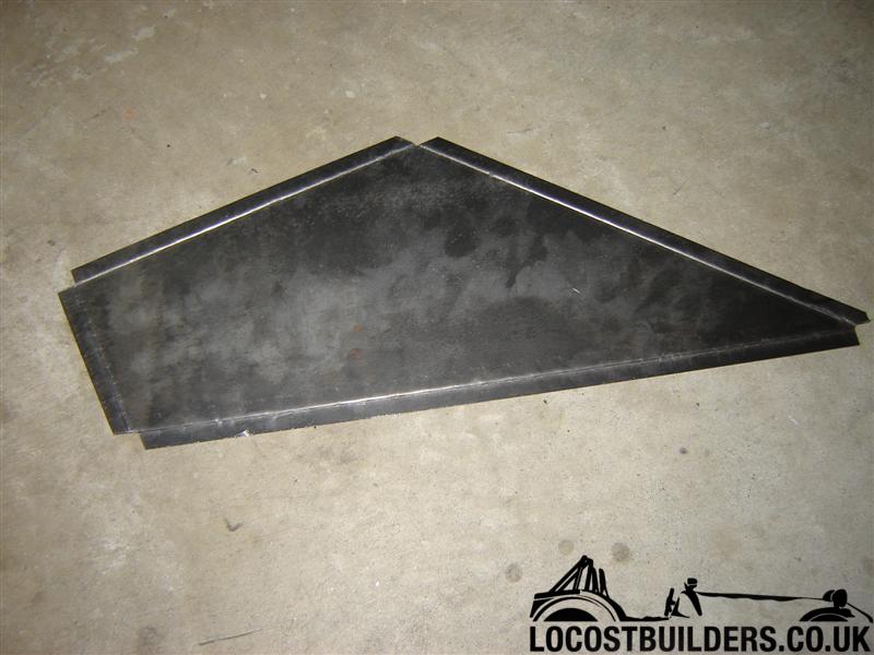

Just finished making my chassis infill panels, and am pleased with the result
I'm about to weld these in, but wonder if they should be fully welded or just partially. If partially, how long and how frequent should the
beads be? They are made with 14 gauge steel.

I fully welded mine but i did stitch them in first then filled the rest in after to avoid too much distortion.

Is Canadian 14g different to U.K. dimensions, about 1.6mm? I tacked mine in using 3"ish tack and similar gap and am now wondering whether to
bother filling the rest in as they are definitely not going to go anywhere.

Definately tack every inch then infill working diagonally across the car, my first floor was a buckled diaster which I cut out and replaced !
Even then it was tack welded but I kept going whene infilling instead of swapping side every couple of inches...

Plug welding (spot welding with MIG) works well when welding this type situation. A special nozzle is available to make it easier.
http://www.mig-welding.co.uk/plug-weld.htm
http://www.esabna.com/EUWeb/MIG_handbook/592mig11_1.htm
With plug welding you can use pop rivets to hold the panel in place thus avoiding distortion
To spot weld to thicker material such as 1.5/1.6 mm with a hobby Mig I drill both parts to be welded the lower part I use a 2mm dia\ hole the
upper a 4mm hole as this aids penetration.
It is also an ideal joint for gas bronze welding.

14g too much, eh? When I asked before, most here had used 3mm! Oh well, that's what I had, so that's what I used.
