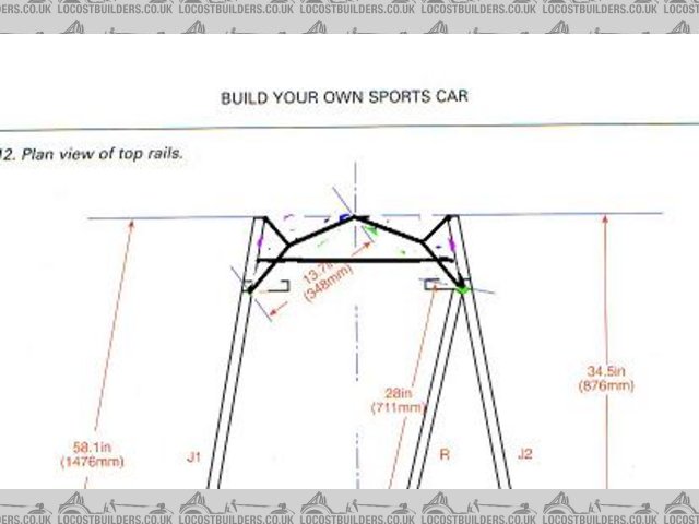

I have struck a problem. Due to the size of my engine, tubes T and S (in original book) dont quite fit. They will fit if i make them 3/4 of the length
but that may be defeating the point of them. Any suggestions?

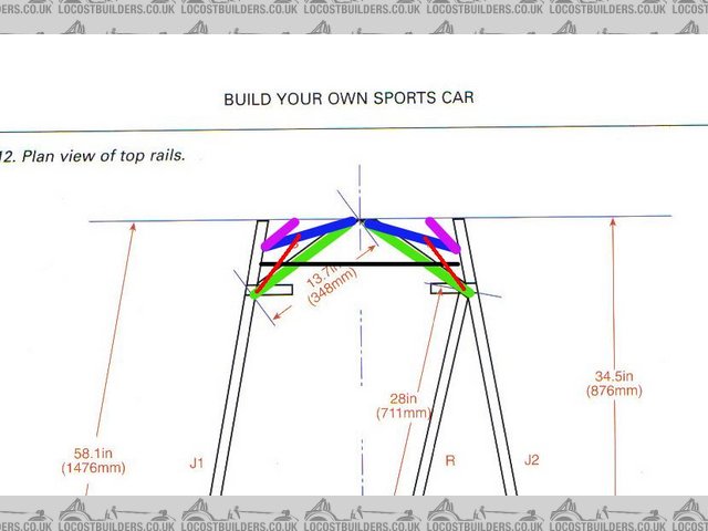

This should make more sense. The tubes (green) will only fit if i move them to where the blue ones are. Does this matter?
speedyxjs
| posted on 20/12/07 at 08:27 PM |
This might help

Looking at the book the tube length looks to be quite critical.
How much were you looking to be shorten them by ?
I have just noticed by about 25%. A tad too much I think.
They look like they provide critical triagulation for the upper wishbone assemblys, tr1 & tr2, fu1 &fu2.
I am sure you will get some more advice on this.
Ronnie
| posted on 20/12/07 at 08:32 PM |
can't you do a curved piece instead, you've not left every much, a bit drastic
| posted on 20/12/07 at 08:36 PM |
can you mark out where the engine will sit? i think i can see some more triangulation possiblities, but don't want to draw them out if
there's a good reason why it won't work i'm lazy like that
| posted on 20/12/07 at 08:38 PM |
this is what MK did, it has left a lot more room

speedyxjs
| posted on 20/12/07 at 08:41 PM |
Ok.
Green line = original design
Blue line = obviously wont work
Pink line = Another idea (waiting for abuse
Black line = Where engine comes to (approx)
Edit - Liking you idea Mr W
[Edited on 20-12-07 by speedyxjs]

pink is nuts

bent tubes are bad. bent square section where one wall is buckled in seems even worse.
if i were to need the extra space, i'd go for something like below. it'd be harder to weld, but i'd imagine you could get into it all
if you were a bit creative with mig shrouds

i would go with something like this (red), and maybe continue them forward past the blue ones like the pink ones
