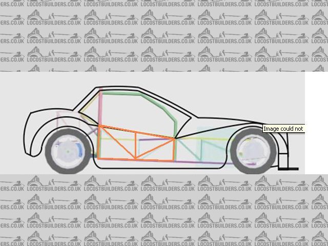

If you look at the design attached, I think there is capacity for the upper engine bay rail to run up to the bend in the cage, at the base of the windscreen. Would this not improve rigidity?
Suspension geometry tool here >>> http://www.locostbuilders.co.uk/viewthread.php?tid=81376
posted on 4/2/08 at 12:30 PM Reply With Quote
Perhaps the tubes rearranged as below in orange would enhance the strength Rescued attachment car.JPG

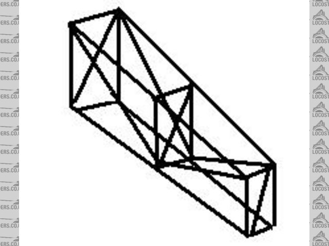

also I think I remember that this was quite a wide car, so one thing you could do is make the sides into trusses like this particularly dreadful sketch. Doing that would make the car a lot stiffer and safer in a side impact. Rescued attachment truss.JPG
LOL, oddly enough, they already do! They were obscured by the ouline of the body work. What you could see was actually the tunnel inside.
