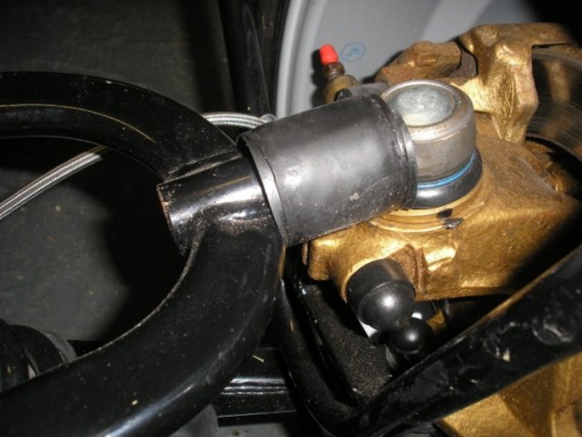

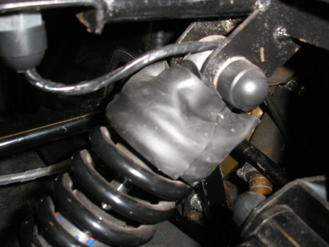

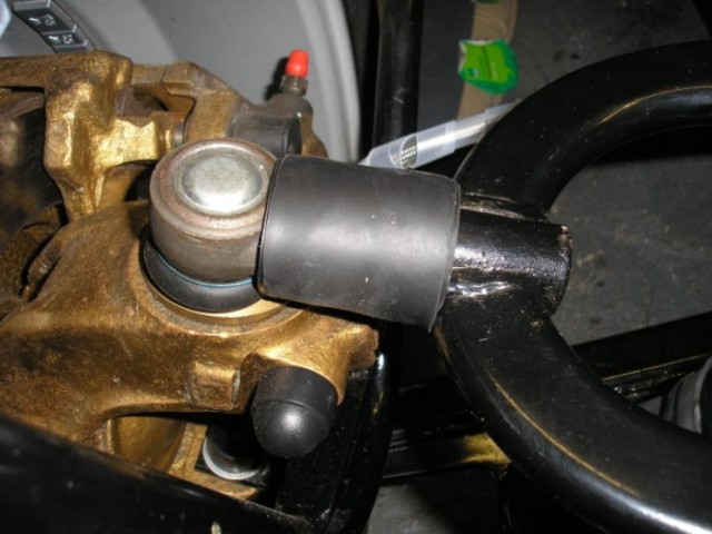

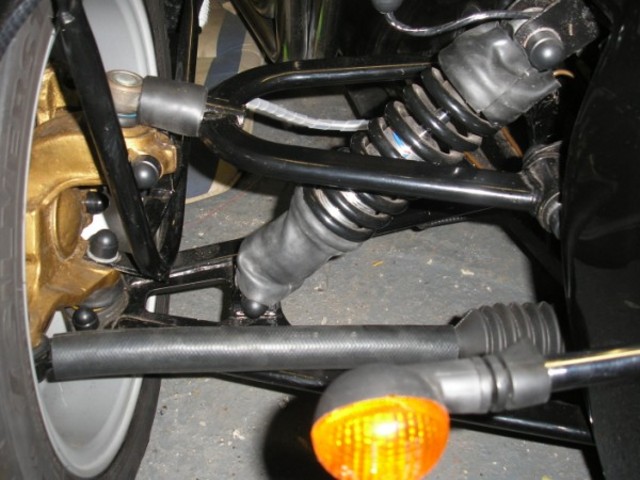

hi all, i just throught i would post up some pictures of my mk indy all done. i am sending the forms for the sva soon, once i get some photos printed out.
right then here is a few pictures of my mk:
front sva prep:
sva
sva
sva1
sva1
sva2
sva2
sva3
sva3

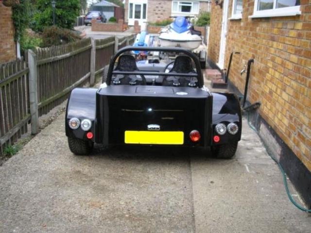

the back
Finshed
Finshed

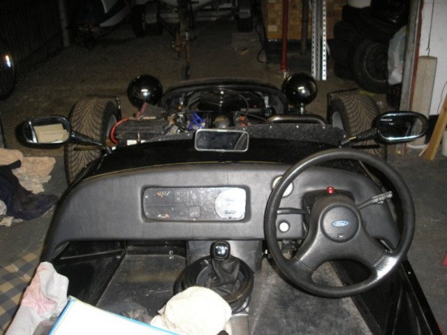

the dash:
Finshed
Finshed

well done but after the test please remove all that rubber...

Are your top harness mountings higher than the bottom edge of the holes in the seats? They'll need to be for SVA or the seat has to be structural.

i looked at the hieght, i have all ready lowered my seats, and i have checked teh mesurment, i am about 20mm under the alloance.

I didn't mean the measurement from the reference point if thats what you've measured. As well as that, the mountings have to be higher than the edge where they pass through the seat or the seat will be regarded as the mounting point.
They used a spirit level between the mounting and the hole to check mine at SVA. Hard to tell from the pictures but yours look lower.

hi, from the back picture, since that has been taken i have lowerd the seats by 50mm.
