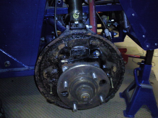

major
| posted on 13/4/09 at 05:49 AM |
Jep, up-side down

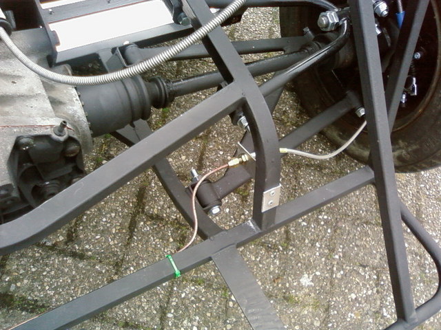

  brakeline routing back
Working on it today.
