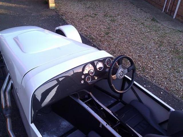

I have been building my Indy R for about 18 months now. Progress has been slow but I have spent a lot more time on it over the last couple of months. Now it is starting to look like a car.
The front arhces are only resting on the wheels for the picture, I have still got the fun job of bending the stays.
The engine has run badly for a few seconds. Hopefully will get the wiring finshed properly in the next couple of weeks so I can try the engine again.
After engine is running it is off to be painted.

Proby
posted on 3/10/11 at 12:18 PM Reply With Quote
Looks good, I like your dash layout, looks very neat.
L5W
posted on 3/10/11 at 08:22 PM Reply With Quote
Very nice! I like your dash layout too. Looks like we're both at a similar stage in the build.

JeffJeffers
posted on 3/10/11 at 09:41 PM Reply With Quote
Lee
Thanks all.
I must admit Lee I have used your build blog a lot for ideas and help. It has been a really helpful blog.

coming along nicely, I also think the dash layout is really well done.

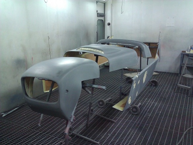

A had a fairy productive day in the garage today unlike yesterday.
I was at work Saturday morning which normally would be rubbish but I knew we would be painting my panels so I was looking forward to going for once.
Me and Ed ,the painter, had stopped late Wednesday night and sanded down the already primered panels. So all we had to do is mask them and it would be time for the colour.
After what seemed like hours of masking the panels where set out in the paint bay for painting.
Panels ready
Panels ready
The problem came when we went to mix the paint. One of the colour ingredients had been used on the Friday. So we was unsure if there would be enough. We thought we would give it ago but we barely had enough for one coat.
So now we need to order some more paint Monday, do a load more sanding to key the surface and then have another go.

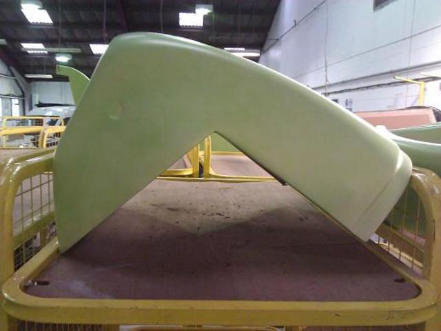

This is what a wasted day of painting looks like. It is kind of a marble affect.

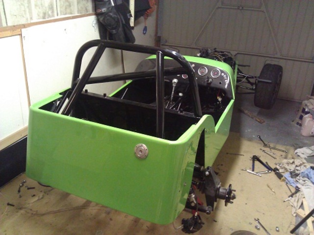

Better day of painting today. I'm really happy with how it looks and can't wait to see it in the sunlight.

procomp
posted on 26/11/11 at 03:43 PM Reply With Quote
Just one observation. The front dampers are on upside down IE the adjuster knobs at the top. The end result of that will be air where there should be oil and no damping. !!!
Cheers Matt
JeffJeffers
posted on 28/11/11 at 09:53 AM Reply With Quote
Cheers Matt
The front dampers are fitted with the adjuster knob at the bottom now. That picture must have been taken when I was having problems getting the dampers to fit.
Thanks for the warning.
procomp
posted on 28/11/11 at 07:46 PM Reply With Quote
Always worth mentioning as all the MK Indy R's i have setup have had the front dampers on upside down and has been one off the main reasons for poor handling.
Cheers Matt

JeffJeffers
posted on 19/1/12 at 04:08 PM Reply With Quote
I have been fairly busy over the last few weeks.
Got most of my panels fitted now properly so it looks a bit more like a car.
19th jan 2012
19th jan 2012
I had a few problems getting my engine to run properly so I decided to trailer the car to my work to see if some of the mechanics could help. Didn't take to long to find it was a problem with the idle control valve. With that fitted correctly the engine seemed to run really well.

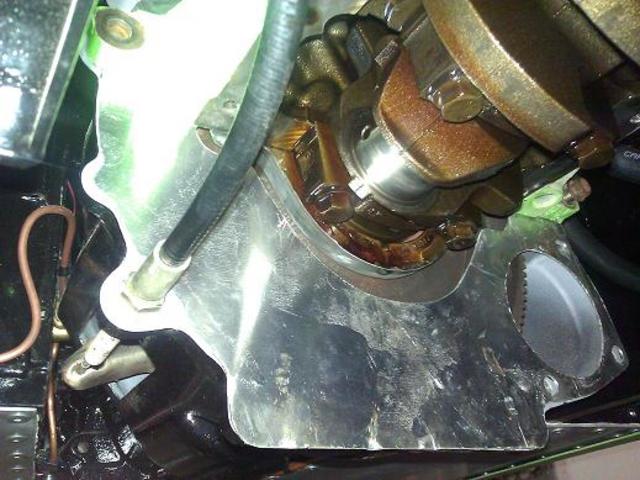

After it had been running for a few minutes we noticed a knocking noise. It sounded a lot like a bottom end rattle.
So I stopped late that night and removed the sump to have a look what I could find. No.4 Shell looks in a very sorry state and has damaged the crank. So now the engine is coming out again.
