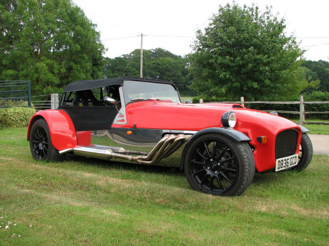

Soft bits did a great job on mine
Tried to upload pic but failed!
poppers on the screen are ok in excess of 100!
[Edited on 17/7/12 by kenton]

kenton
| posted on 17/7/12 at 08:44 PM |
  viento compleated
