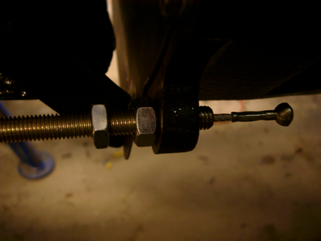

third question, same as the second one really but regarding the clutch cable. what do i need to get to adapt it to the mk pedals? also how do i get
some adjustment in it?

The clutchcable I used is part no BB11010C from Burton Power
And the throttle cable I used from the Sierra, I just shortened it.
Sorry but no god pics of this
Click it
macspeedy
| posted on 13/10/04 at 08:43 PM |
clutch pedal end
just found this
http://www.locostbuilders.co.uk/photos.php?action=showphoto&photo=image004.jpg
