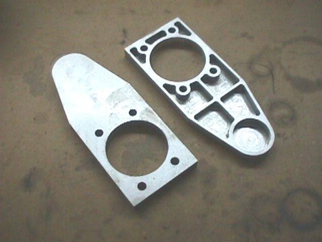

I just got mine.
I have them in 0.5" and they are rubber bushed. You can have them with spherical bearings.
Very nice and light.
Fronts weigh 1.7Kg each with springs and rear weighs just 1.55kg each with springs

woah, those de dion end bits are a bit beefy arent they? looks like a tow hoop from a tank!
phil_far
| posted on 25/8/05 at 04:26 PM |
They are CNC machined and hollow from the inside. The uprights just weight 1.1kg each, the trailing arm brackets 1kg and the tube is a seamless 3mm
thick and weighs 6kg. Combined weight is just 2kg off a double wishbone setup

By the way teh trainling arm brackets are laser cut and folded into shape thsu hollw from teh inside as well

Yes the brackets are for spherical bearings. I do understand your concern and is very valid but I have seen it on others. Maybe its worth changing
just before I send everything to the paintshop
I have attached a photo of the rear upright form teh inside showing the weight saving
