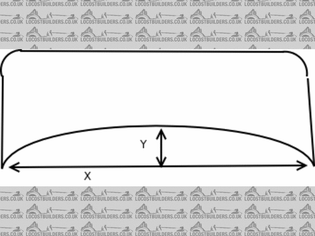

Thanks phil, See attached for pic that would help a little..

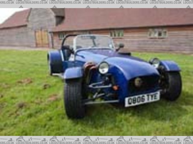

I've got an old westie screen on my Indy,i'll have a measure up as i do not really know what generation westfield its from.
Its not a perfect fit but hey what is on these cars

On my screen X = 890mm and Y = 100mm.
Inperfections on the arc are taken away by the rubber sealing strip whiich was purchased from lolocost (robin hood) for about £5.
I wasnt sure how it was going to turn out but at £70 including ali screen supports i could hang a barn door on i'm happy

Yes from the absolute corner tips of the frame,the screen was a total bad fit on the upper tier of the scuttle but works a lot better sitting in front
of the lip.
I have a small gap i need to fillet inbetween the screen supports and the scuttle but it is hardly noticable, just another job on the list

Sorry for the delay. Just been out to measure my screen. X is 89cm and Y is 7.4cm. Hope that helps. That's with the screen off the car, and no
rubbers in the way, so it's accurate.
