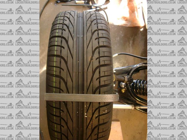

I've just done the first bend on the first bracket and I just know its crap already!
I'm using MK brackets and the old style wings, without the bulges, Well I think I am , at the moment I feel like burning the lot already and
getting some that fit from somehere if they exist
The tyres are 195 50 15 and are about 8" wide, the wings are only 9" wide, is it ever going to work?
The tube part doesnt seem to come high enough either, meaning that the wings have to be higher than I would prefer (see pic).
And I would like a closer radius to the tyre to , but thats another story
OK rant over, but any suggestions or tips gratefully recieved.
Do Dax sell wings and brackets to fit Sierra uprights and 15" wheels?
Thanks, I feel better now

| posted on 12/4/06 at 09:33 AM |
The one in the first picture looks the wrong way round.

| posted on 12/4/06 at 03:24 PM |
I mean it looks like the legs on the stay are the wrong way round, sorry. Like if the piece in the middle was welded in the wrong orientation with the
short leg to the back.
ReMan
| posted on 12/4/06 at 09:57 PM |
I think you could be right?
I've not ordered any today, thought i'd have one more try, but its not looking hopeful and that could be why?
