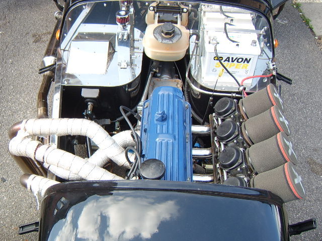

Couple of pics of my Indy. A couple of small jobs to check over. All comments good or bad welcome

Looks great!
Good luck with the SVA - hope to be doing mine next month.
How well do the bike carbs work?
Stu
| posted on 10/8/06 at 03:39 PM |
Nige!
Looks fantastic
You've put my build speed to serious shame now.
Best of luck for SVA - let us know how you get on.
Couple of questions...

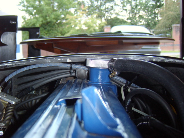

1. How have you routed your coolant pipework?
2. How did you get the oil filler cap to fit under the nose/bonnet>
[Edited on 10/8/06 by nick205]

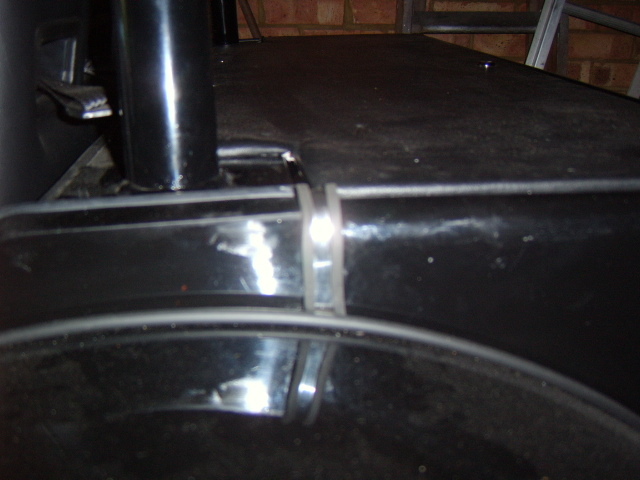

looks very nice mate, good luck! what have you done to the rear to side panel edge to make i sva safe?

You'll need a cover over the positive terminal of the battery.
Otherwise looks excellent.

Is the rear panel joint definately an SVA fail then?
Anyone know what MK recommend to get through?

Toady 1 the rear panels are covered with a 32mm stainless P-clip with rubber cover.

Hi Nick, i had a friend make a billeted ali cap to fit under the bonnet.
Coolant system. I have a polo rad from a 1.1 which has large top, large bottom, small top breather.
Expansion is Rover 200 top and bottom inlet.

Hope this makes sense.
