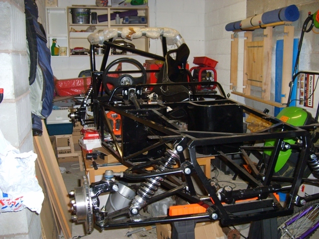

It's not much, but I'm happy with it!
This is a moment for my own posterity - it'll be on it's wheels for the first time tomorrow!
No brakes in as yet, but having the ability to roll it onto the drive will make life a lot easier than trying to tip toe around the thing to get stuff
done (plus the garage is a complete mess because I get get anything swept up properly!)
It has actually got all of the steering attached and working though!

Looking very tidy, I remember that stage well, Its great to get them on the ground.

I'd have liked to have the brakes etc. in place, so it becomes a proper rolling chassis. Space is proving a problem at the moment though, so a
couple of wooden chocks will be the order of the day!
How have you put the sterring rod extentions on your car? At the outside, so the TRE is on the end of it and it adjusts between the rod and
extention?
stevec
| posted on 21/9/06 at 08:25 PM |
The track rod ends are tightened onto the extensions.
The extensions are screwed on to the tie rods that come out of the rack. Then you rotate the tie rods to give you adjustment for the tracking.
You may need to slacken the clips on the rack gaitors to stop them winding up.
Steve.
StevieB
| posted on 21/9/06 at 08:27 PM |
Presumably the lock nuts tighten up against the extentions then?

I should hopefully have this thing dropped onto it's wheels this afternoon with a little help from Mark.
I've got a few problems with the steering at the moment (steering column bush doesn't seem to fit too well - I'd be grateful if
anyone with photo's of this fitted could post them).

Is this any help?
  Steering Bush

I think the steering bush is wrong because I've put it in the other way around
Guinness
| posted on 22/9/06 at 08:45 AM |
I never said I got it right! But it works for me so far!

Notice you've got those plastic chassis stands. Be careful when getting it down, at least one person on here has had them collapse They
don't like having any twist applied, easy to do when shoving it around to get a better grip.
StevieB
| posted on 22/9/06 at 09:09 AM |
They're already bending a little under the weight - I';m dropping it before I should because I don't want to here that crash in the
nmiddle of the night when it all goes wrong!
