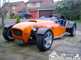

just though i would post a few pics of the fazer conversion from my pinto. Just in time for tom to be 17!!!

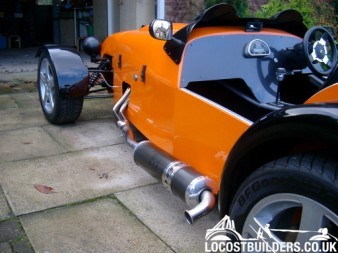

Big thanks to Jacko for his welding and endless bits and bobs! and also to
Andy W for modifiying the exhaust can!
Just to tax it and then give it a good shakedown
cheers Tim

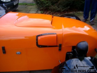

Thats more like it Tim,you must have had a bump on the head to even think about fitting a pinto in,after having the 929 blade,I do like those MAC1
screens,and the cold air feed to the air box in the side of the bonnet is a nice touch,and make sure your Tom takes it easy when he gets behind the
wheel.

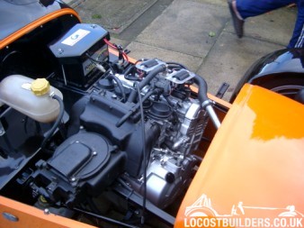

Looks a very tidy install, well done. Is that a car battery in the engine bay? Maybe time for a bike battery and a useful bit of weight loss.

Hi Tim - Tom am glad i could help it,s a nice fitting engine with the original air fillter without any mods

I would junk the Kleen air system just take it off and blank up the exhaust maifold holes with bolts/copper wasers.
also the R1 theromstat works well the Faser if you think you need it
(tis a good engine the faser!)
