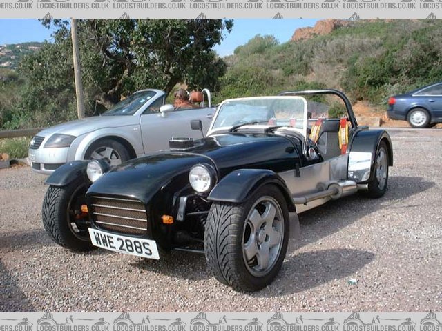

car in France
car in France
If you look at mine, I made some ally protectors for my 'ears'. SVA bloke liked 'em. They're still on 2 years later!
