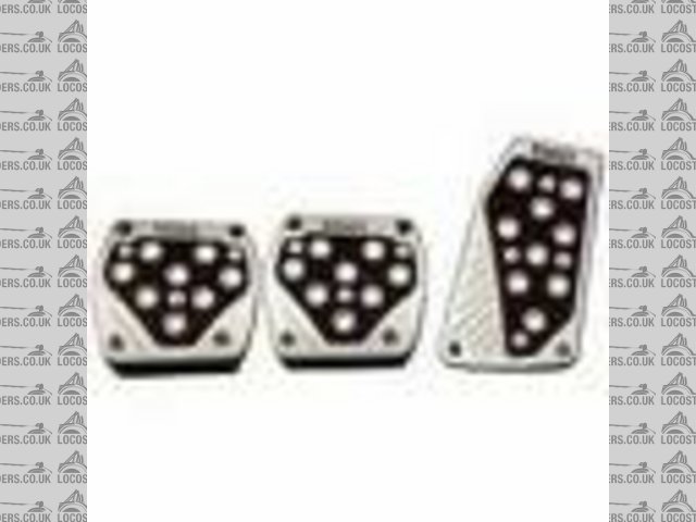

What have people done to make their MK pedals less slippery. I've looked at some aftermarket cover sets, but they al seem to require a larger
surface to attatch to than the MK pedals have.
  pedal covers
Any ideas?

Just take into account,there is not alot of room in the foot well on a Indy,and the pedals are very close together,add to this a set of wide pedals
like the ones pictured in your original post,and you could end up pressing the throttle pedal at the same time as the brake,with your average size 10
footwear on,so if you want to go for the sporty look go for the narrowest pedals you can find,these are also easier to fit to the narrow Indy
pedals..jpg)
