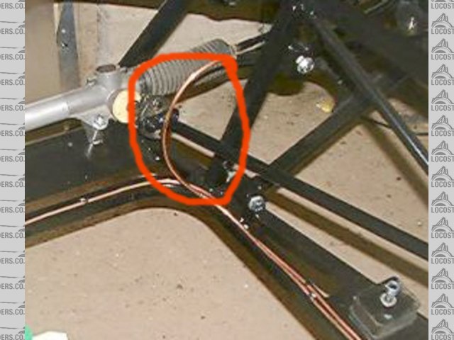

Routed mine like so, bit of guess work really on my part.
Pez

| posted on 16/6/07 at 10:17 PM |
Has this passed SVA? They don't usually like this much floating in space.

Those floating lines need addressing I think too. Loop them up with an extra p Clip. I didn't bother measuring the gaps on mine, just went for
a PClip before each bend and one after. Came to around 100mm to 150mm between clips (and intentionally about 100mm along the tunnel). That way if a
clip does break I've still got around 300mm spacing rather than a line that could catch on something before I notice it

40inches
| posted on 17/6/07 at 05:07 PM |
Bugger! Spose I'll have to redo these then?
