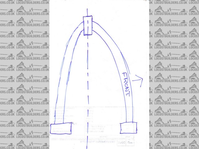

Sorry to odd my share but don't forget the top wishbones are left and right handed, I think it's the long leg to the front
tony
mad-butcher
| posted on 12/1/08 at 08:28 PM |
sorry about drawing if I'm wrong some-one will correct me

Tommorows job is to flip the top bones around, rembering what Tony said about making sure the long arm is at the front.
