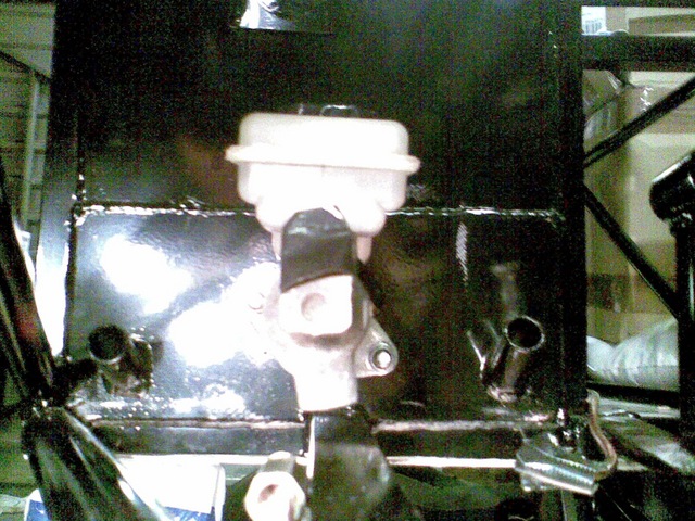

Hi, i'm building an R spec chassis Indy.
I've come to fit the master cylinder from the donor seirra, but the bottom fluid outlet only has about 16mm of clearance from one of the chassis
bars. Have I mounted it wrong or what are my options.
I've been to my local motorfactors and they have told me that they have no right angle connectors that tight.
Sorry about the pants photo.

Hi there. I had the same problem with mine. You just have to tlit the BMC so that the copper break pipe at the bottom just clears the chassis rail.
Make an S shape with the pipe and P clip it to the rail.
Where are you based?
Paul

Common as muck these spec R zx10's,you can either as Paul says just by slightly tilting the master cylinder you can fit the pipe,or could always
fit a wilwood master cylinder like Ive fitted to mine..jpg)

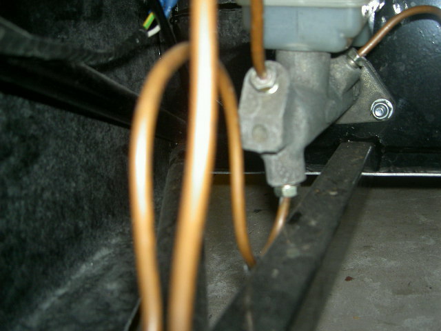

paulmw
| posted on 9/4/08 at 07:38 PM |
Common Picture of mine

paulmw
| posted on 9/4/08 at 07:54 PM |
Cropped the pic to suit.
Cant beat management black

marv
| posted on 10/4/08 at 01:18 PM |
Thanks for your input:
paulmw: I'm in Hitchin, Hertfordshire.
PAUL FISHER:I thought about a nice shiny new willwood master but since I had the old seirra one and I had my sensible hat on i've stuck with the
sierra. Looks like i'll have to tilt it slightly.
Thanks all.
