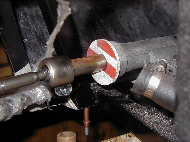

large for ally rack small for steel rack
mad-butcher
| posted on 10/6/08 at 07:37 AM |
fitted on rack to prevent (technical description) swively bit disappearing into rack

Can't take no credit for idea, it was an old idea when I did it in 2004
better pic
