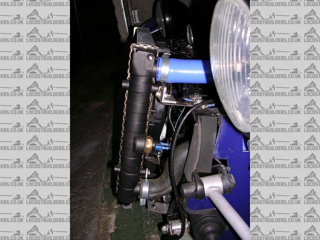

SyKaTurbo
| posted on 4/10/08 at 09:33 AM |
Bob has some good pics in his archive. I did mine in a similar way to him and its very sturdy.
  bottom mount
  n/s rad
[img][/img]
NS Dev
| posted on 4/10/08 at 09:52 AM |
I used the bosses same as syka turbo in photos above, just tapped em out for M6 bolts

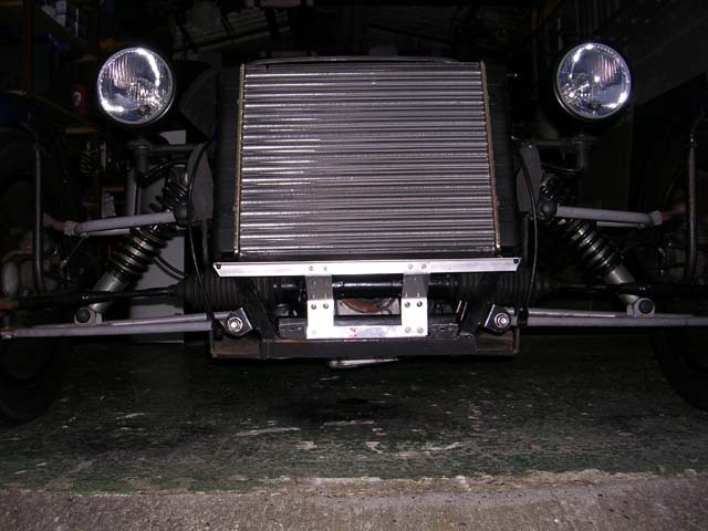

jollygreengiant
| posted on 4/10/08 at 12:36 PM |
I made an alli mounting plate that bolts to the front of the chassis after the rad is bolted to it and mounted onto the locating lugs at the
bottom.
  Rad mounting plate from bacl/bottom
fitted to car
  Rad & mounting plate on car
SyKaTurbo
| posted on 4/10/08 at 01:54 PM |
Awesome bit of work there!
