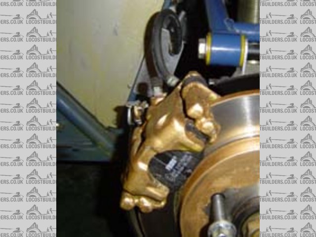

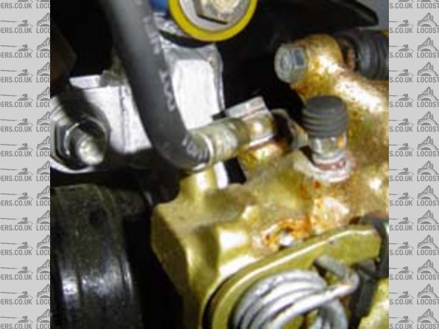

Has anyone got any pictures of a rear disk setup on an Avon? Do the calipers end up on the front or the back of the uprights?
I've tried searching, but can't find anything. I think pictures have been posted before.
Hi Graham,
Look at Lightning's photo archive (rear end chassis and diff).
I think that'll answer your question.

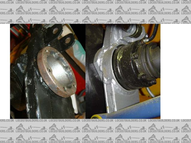

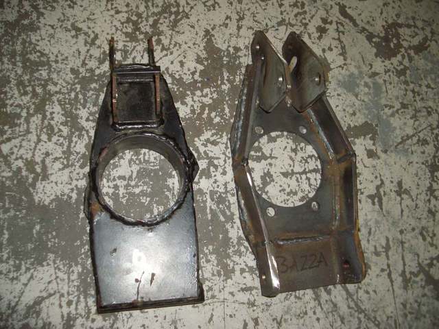

New rear uprights created:
Tigers own compared

Told you all - new tube in the upright. An afternoons work and hardly any expense. Job done.
Pat...
Pat,
How do you suggestyou do that then Easily?
Don't you think it would be easier to make new ones?
Check out the photos, of before and after.
me thinks you need a very well equiped workshop to be able to do that (twice) in an afternoon.
Maybe a long afternoon then.

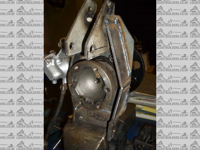

Hey that my upright on the right.Stripped the suspension made the jig and did the mods in about 3 hrs. It takes longer for the paint to dry.
Come on Graham get you finger out. I will have passed my SVA at this rate.
Carl
PS Thats both in 3 hrs
[Edited on 16/3/05 by carlgeldard]
But Carl, aren't you a welder? And didn't you make them from scratch?
As I said, probably easier to make them from scratch, rather than modify existing ones
Yes I was a welder in a passed life. The uprights were bought from Tiger thats why I have modified them just like everthing from Tiger.

Graham do you want me to modify your uprights for you.
Carl
Carl
Music to my ears!
How did you do it Carl? I don't think I'd trust my welding to suspension parts
Did you alter the mounting plate also to put the holes in the right place?
[Edited on 16/3/05 by Northy]
Why don't I do Graham's uprights and he can take photos and write a description. Then post the results on here for you to do yourself. A
small price to pay don't you think Graham.
Carl

...Uprights were then swapped from one side to another to enable callipers to be fitted. (photo shows clearance which now exhists between stubshaft
and upright)..
...pic of L/H rear hub assy..

..pic of R/H disc and calliper..

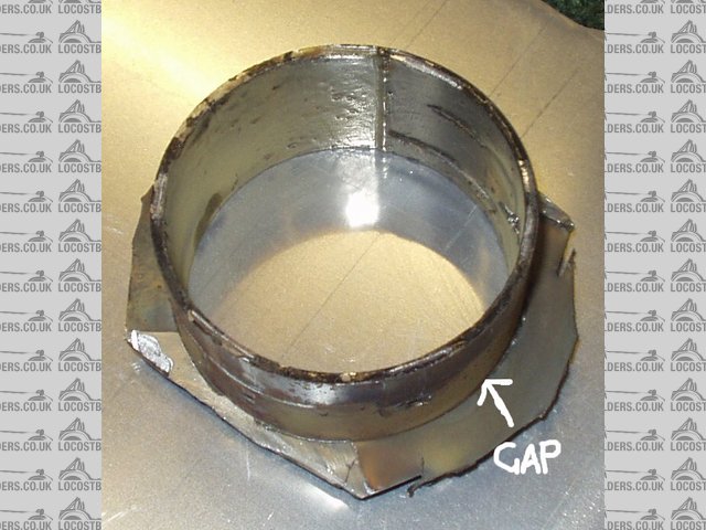

) the photo will show the holes I had to elongate (the two to the left in pic!)
Andrew,
Did you remove material from A & B? What about C?
How much clearance is there now between the edge of C and the back of the upright?
From that angle it looks like the tube is welder off centre GOOD JOB IT'S NOT!!!! And you could have painted them first.
Carl
Didn't have time to paint them Carl, went shopping remember!
Didn't get to Elvington either.
Will paint them tomorrow and take better pics.
The tube is central everyone, just my crap camera work (my head is filling with snot!)

one of mine, modded it a bit soon after this by removing the shock mount...
And now you're just showing off Viper!
Welcome back,
Pat...
hardley showing off, mine is far from finished
Andy / Carl,
How have you routed your flexy brake lines and handbrake cable? It looks like my flexy lines will foul on the end of the top wishbone.
I might
have to get some bango style ends?
Graham,
Firstly, did you swap your uprights from one side to the other, so that the callipers are rearmost or kept them as they were in which case, the
callipers will sit in front of the hubs?
(It doesn't make any difference - the flexi hoses will still foul on the upper wishbones!
I'm also at the stage of sorting out how to fit the hoses.
I reckon there's about 40 mm clearance between the calliper and 'bone - too tight to bend the hoses to fit.
I believe Lightning fitted some sort of pre-formed right-angled bend to his callipers and then fitted the hoses to this. I,ve approached a local firm

Thanks for the reply Andy. I swoped the uprights so the calipers are at the rear, I think it looks better
I got Stainless braided lines made up by Rally design with the bolt on style ends, so I should be able to take the end off and replace them with bango
style ones
Have you seen the Rally design ones? They'll make any length you want, and cheap.
Originally posted by Northy
Thanks for the reply Andy. I swoped the uprights so the calipers are at the rear, I think it looks better![]()
I got Stainless braided lines made up by Rally design with the bolt on style ends, so I should be able to take the end off and replace them with bango style onesHave you seen the Rally design ones? They'll make any length you want, and cheap.

Yeah, what Carl said. I fully agree. Here's a picture.
Basically between the metal that is the rear face of the upright and the tube itself there is a gap, as the rear face was welded on last during
manufacture. So when you've ground all the weld away, you've ground all the strength out of it!

Andy, I can answer some of that!
On mine there was only four 'tack' welds holding the tube to the outer face, as you can see from the picture the tube is perfectly intact.
If you look carefully you can see holes in it about halfway up where Carl drilled the four tacks out.
Can you see in the picture? Shall I mark them?
On mine there was only four 'tack' welds holding the tube to the outer face, as you can see from the picture the tube is perfectly intact. If you look carefully you can see holes in it about halfway up where Carl drilled the four tacks out.
The tack welds on the inside are the just to help the welder hold the assembly together during the fabrication process all the strenght comes from the
welds on the outside of the upright. And one of the largest welds is no longer there.
Carl
