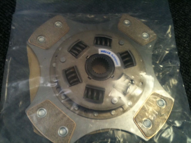

laptoprob
| posted on 25/1/11 at 07:28 AM |
New goodies
Newly built engine now fitted.
Now 2.1 with 12:1 Omega pistons,Steel rods,Cometic head gasket,ported+polished head,solid lifters
and Autosprint 302 dur/11mm lift cams.
Lightened flywheel now fitted along with Helix twin paddle sprung clutch and cover.
Tran X gearbox now fitted 2.48/1.69/1.21/1.1/0.87
  228mm Sprung paddle clutch
Image deleted by owner
[Edited on 25/1/11 by laptoprob]
