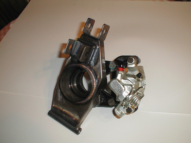

| posted on 29/10/02 at 09:03 PM |
uprights
the uprights i made are not quite the same as the book because i am using a rose joint in the top wishbones so i can sdjust rear toe in without
overloading the lower wishbone, and i am using discs so the mounting plate is different.

gjn200
| posted on 30/10/02 at 01:24 PM |
Look good, nice tig, but the jurys still out on the S/steel, I get lots of problems with it cracking at work (food ind). do you think the standard
ones could be modded to fit lobro shafts easy?

Viper
| posted on 30/10/02 at 08:11 PM |
Stainless?? whereabouts?
I havent got the book to hand so i am not sure of the wall thickness of the tube they use if memory serves you will need an I/D of 83mm.
gjn200
| posted on 31/10/02 at 05:40 PM |
Looks like it to me, maybe my screens dying.........
