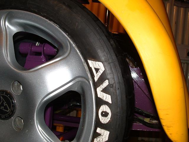

| posted on 11/3/07 at 07:06 PM |
success at last...
after spending this afternoon examining tractor boy's Avon I got home abd attacked the bodywork. end result....
  rear arch 2
Dave
