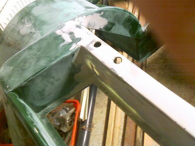

why do tiger do it?
why does the avon tub come with the front section of the boot cut out.I wasn't happy wit this so i rebuilt it back up to create proper boot space
(if it ever existed in the first place!)
Also ive re made the shut line on the bonnet,extended under the nose cone, re enforsed the side where you get in/out,repaired the o/s wheel arch and
this was a new body from tiger
Do they all fit this bad?

once its all re sprayed it should look nice and neat around the harness mounting points

Yes. They are all that bad from what I've seen. Just took the body off my (admittedly old, so they might not have has as much practice then)
Super Six and in places there was an INCH of tigerseal (aptly named....) filling the gaps between the bodywork and the chassis.
It will be repanelled in aluminium where I can and the fibreglass will be modified to fit properly where I have to use it. Pics here:
