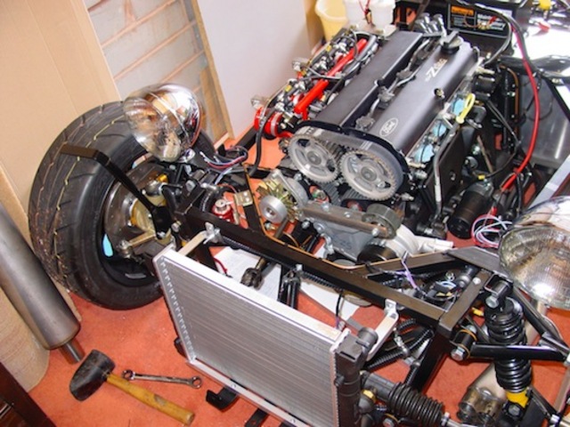

Hi guys, many months since my last post. My Avon is nearing its completion..only a few things to sort.
I have fitted a polo rad, new black top zetec with tb's and new shortened sump...Tiger have supplied all the parts so far and all i looking
well..Although i do need some help when it comes to fuel and cooling???
Does anyone here know how to pipe the cooling system? Standard 2.0l engine thermostat housing, no heater as opting for no windscreen....Also with
regards to the fuel, do i fit the pump before the filter or visa versa? Any help would be great.

rad fitted
  Rad fitted

That left hand side repeater on the first picture will never get through IVA
Nice build apart from that

just out of interest what tyres do you have on your car ?
RichardK
| posted on 14/6/10 at 10:25 PM |
On the big picture they have R888 on the side

Yes, the tyres are TOYO R888's, very soft and sticky...Road legal i think?????
Do i need to conect all therm housing connections for the cooling system>? or can i blank off the two small ports??
