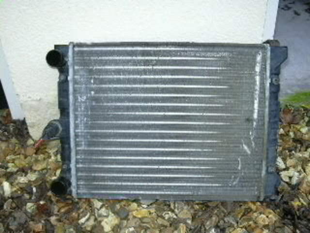

just been to the scarp yard and got
a rad from a G reg polo please couuld
tell me from the pic is it the right one tks.
paulf
| posted on 27/11/04 at 04:42 PM |
Yes
that is the same as the rad i used in my car. I made two brackets with holes drilled in them to locate on the bottom mounting pegs and two brackets
that attached to the tapped holes for fan mounting at the top.
Paul.
