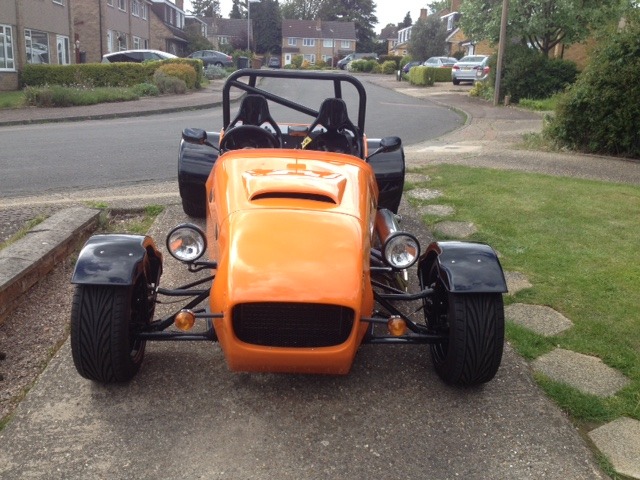

Made mine from bike indicators and some aluminum tube, made them to look nice, I have them still fitted.
They have to be 400mm from widest point on car from memory.
[img]
[/img]

As above IIRC the SVA (back in the day) stated the indicators had to be 400mm or less inwards than the widest part of the car (outside edges of the
rear arches in my case). I used motorbike indicators and made up some extension pipes with M8 nuts swaged into the ends of some Ø15mm copper pipe
then covered with black plastic conduit...

The length of extension is unimportant, as it will vary on width of the nose/side panel and width of car (at widest point, so usually rear arches). As
above its the 400mm from widest point thats important.
