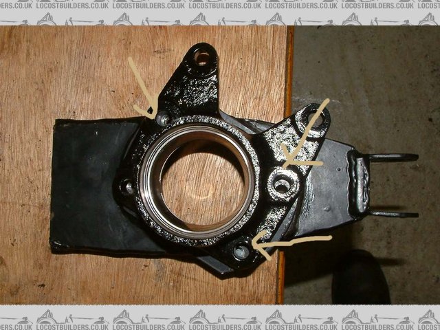

I,ve come to the same problem and found a few sticking points when using the stock avon rear drum upright with disk hubs.
1) The 4 holes of the hub do not line up with the tapped holes in the upright
This has aparently been solved by welding up, redrilling and tapping according to tiger. Just how you are going to drill and tap a hole 15mm? deep is
beyond my ability. You are going to need a neat flat bottom drill bit.
Whilst your at this make sure the holes are dead square around the centre hole or the drive shaft will hit. In its current state it aint pretty.

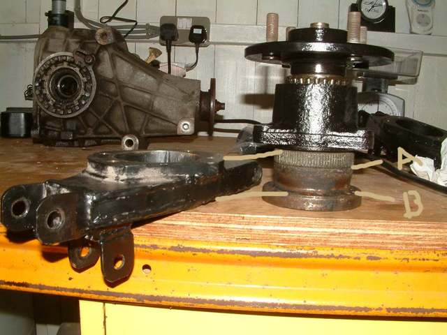

2) The Lobro shaft end is to dam big to fit in the hole. You could lathe it down taking off the ABS teeth so the sides are parallel. POINT A on
3) The Lobro shaft end is to dam short to fit, when the baring is tightened up it pulls the shaft end in to meet the inside edge of the upright,
You would have to lathe some metal off POINT B off the shaft and take back the lip of metal on the inside of the upright.
After much thought I'm going to ebay my uprightd and build completly new ones base on the Luego design of a flat plate that everything is either
welded of bolted to, a vast improvement.

| posted on 21/2/05 at 01:01 PM |
Sierra disk hub placed on avon rear upright
The Holes do not line up. - bugger.

Looking at the photos and comparing them to my, (home made) uprights it appears that the hole spacings are the same. It looks like if you were to turn
the carrier 180 degrees the holes would line up. Unfortunately you won't be able to get the calliper on in this orientation.
Mick

i found that one hole is off centre to the rest on my dedion axle for sierra rear brakes. can you not take the brake bracket plate off and swap it to
the other side, perhaps flipping it over if necessary?

Spinning the hub carrier round 180 degrees makes it worse....
