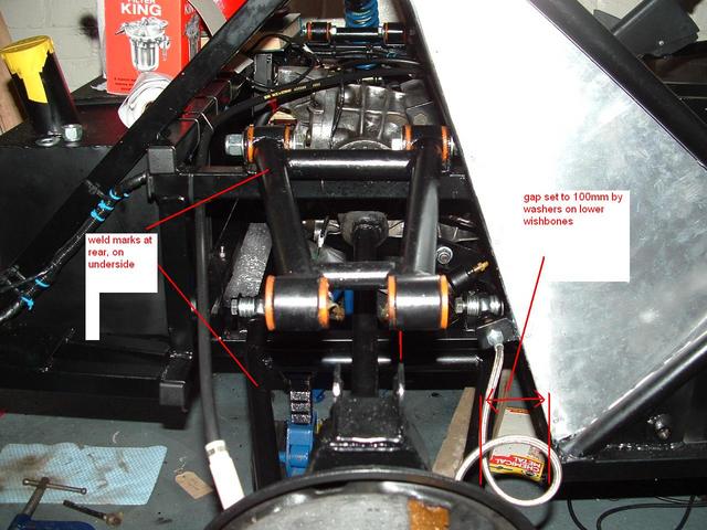

les
| posted on 5/1/07 at 11:34 AM |
Hi guys,
sorry to drag this up again, i also have problems.
I have the weld marks on the wishbones to the rear, on the underside- avon book states that distance from chassis member to the bush housing on the
lower wishbone should be 100mm
but after setting this distance, the hub carrier is completely out of alignment with the upper wishbone and wont slide in!!
shades
| posted on 5/1/07 at 11:40 AM |
There is a sketch in my picture archive as to where the welds should be... Its not easy. From memory I had the wishbones when put on the right way
up right way round pushed all the way back with the spacers to the front of the car.
