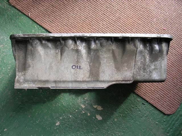

Here is a picture of a silvertop zetec sump from a 2 litre, and i'll follow it up with zetecs 2 litre sump which has been altered and bolted to
an MT75 box.
I hope this helps
bob
| posted on 1/3/07 at 08:27 PM |
better pic
