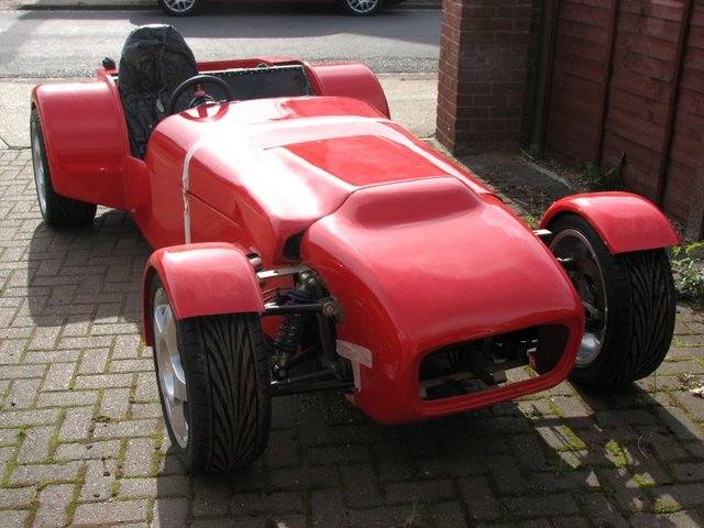

DaveFJ
| posted on 21/5/07 at 04:14 PM |
And another busy weekend
Dave
Rudy
| posted on 22/5/07 at 06:07 AM |
I am impressed from the rear of the car! That tyres looks very good
Sorry about my English
soggy 3
| posted on 22/5/07 at 08:16 PM |
Looking good Dave, you did get inspired at the show!!
