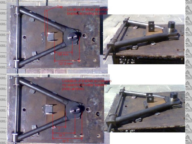

Hi ,I made a Jig (by using book dimensions)for front lower wishbone and try to locate the damper bracket but when i made measurements i realized that
it is different from the original ones that others builders uses as mentioned attached pic.Any help please.

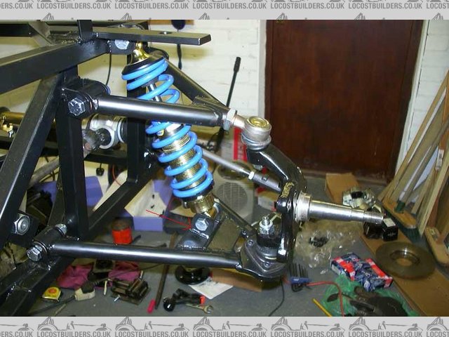

let me send one of the sample picture taken from builder archive that i don't remember now who he is.

It doesn't really matter, but the closer you get them to the bottom ball joint, the better.
IIRC, Tiger are still supplying the wrong length front shocks with Avons and they rest on the bump stops when the bottom bone is level with the
ground.
