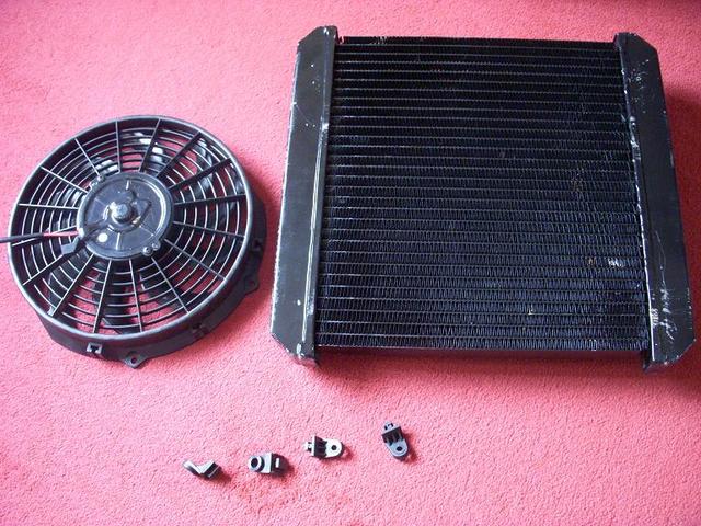

hi,
any advice on how these fit together, all purchased from tiger although i reckon I need to buy additional things to fit them together. do i need
plastic extensions or something to make the four joints fit onto the edges of the rad? cheers.

BenB
| posted on 2/10/07 at 10:26 AM |
The clips look like they're supposed to clip into the fan for extra mounting points...
nib1980
| posted on 2/10/07 at 10:29 AM |
The T shape fits into the four T slots on the Fan, then I made some spacers up from some scrap metal I had, taking the hole and bolting it to my made
up spacers, and finding a suitable lading point on the body (in my case the same as the radiator)

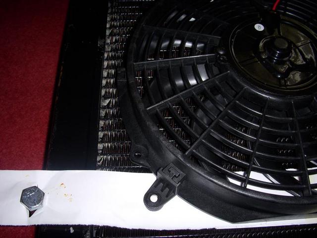

jimbona2
yeah sorry they do. when you place the fan over the rad with the four joints sit over the mesh
jimbona2
| posted on 2/10/07 at 10:32 AM |
putting a bolt through the mesh seems a bit strange. is that okay what what bolt would you reccommend? cheers
[Edited on 2/10/07 by jimbona2]

nib1980
| posted on 2/10/07 at 10:46 AM |
Nope not a bolt through the mesh, I made a spacer up bolted the fan to the spacer (about 15cm long with a hole in each end), then the other end of the
spacer to the body.
Alternativley you can get a cable tie type mount and mount through the radiator mesh (try an ebay search)
nib1980
| posted on 2/10/07 at 10:49 AM |
http://cgi.ebay.co.uk/OIL-COOLER-ELECTRIC-FAN-MOUNTS-WESTFIELD-CATERHAM-7-DAX_W0QQitemZ150167319085QQihZ005QQcategoryZ100921QQrdZ1QQssPageNameZWD1VQQc
mdZViewItem
try these
BenB
| posted on 2/10/07 at 10:51 AM |
Although people go for the cable tie jobbies I wouldn't. They do have the cable-tie serations and it is possible that they can cut through the
radiator core...
Many people use them without problems but people have reported leaks at the site of the cable ties...
I'd go for the strips of metal bolted through the fan brackets and attached to something suitable on the car...

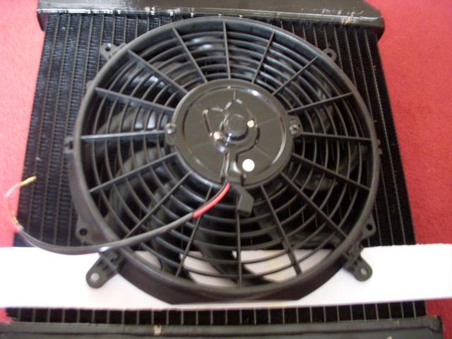

jimbona2
| posted on 2/10/07 at 11:19 AM |
think i got it, like below, forgive the paper but this represents some blank of metal that the bolts can go through.
RazMan
| posted on 2/10/07 at 11:37 AM |
Yep thats the idea, and probably best to leave a small clearance between rad and fan to prevent any contact problems - it won't make any
noticeable difference to the cooling system, although obviously keep the bracketry as minimalist as possible.
[Edited on 2-10-07 by RazMan]
Raz
jimbona2
| posted on 2/10/07 at 11:51 AM |
ok will do, not sure where the paper in the picture would fix to though to be honest?

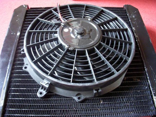

jimbona2
| posted on 2/10/07 at 01:21 PM |
thats what I thought, is it okay to do that? ie...
RazMan
| posted on 2/10/07 at 01:54 PM |
Looks good to me. Try and keep them as short as possible, or maybe make them from angle to give them extra rigidity if needed. The fan itself will
stiffen things up a bit when bolted in anyway.
