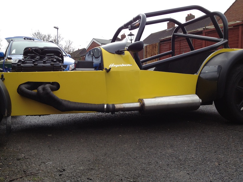

For now, here is the first photo of her at home, but being a photographer - they'll be plenty more.
Yes the heavy 15s will go along with the Kuhmo Ecstas, but got some reading up to do on whether to drop to 13s or not, as the FD is already at 3.14,
so wouldn't want to limit my top speed much more...

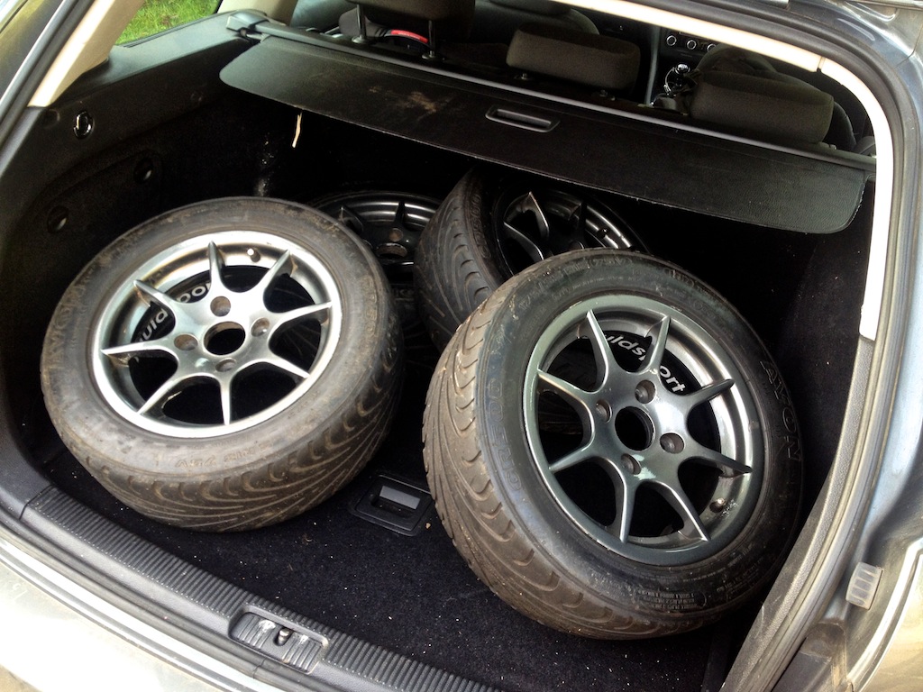

dropping to 13s wont decrease your top speed as long as your on 205/60 at the rear
Awesome, Thanks... so the rolling radius on my current 205/50/15's is the exact same as a 205/60/13... in which case... what to buy...
I'm unfamiliar with even the PCD of my current wheels, I can only presume they are Ford fitment which I believe is 4x108... so I guess the R500
wheels won't fit as I believe they're 4x100...
What offset am I after, and also are they 6J fronts, 8J rears?
the radius is about the same as 195/50/15 so may drop a couple mph my compomotive cxrs are 6 inch front 185/60 and 7 rear 205/60 and the off sets
are about et27 rear and 23 front and seem to sit about right on my old 15s had 6.5 wide and et36. the only problem with 13s is the rear brake
caliper clearance if using sierra calipers i and other here had to remove the coil return spring some on here have sourced a custom small spring, i

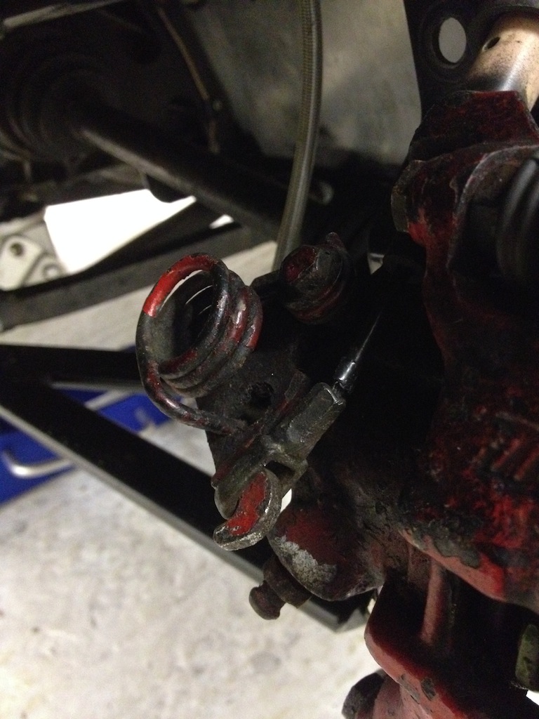

just fitted a compression spring on the hand brake cable, wheel choise is limted to compomotive cxrs team dynamics pro race 1.2 and some expensive
split rims oh think daniel mason on here has cateringvan wheels look very
I have r500's on my Mnr. 4x 108

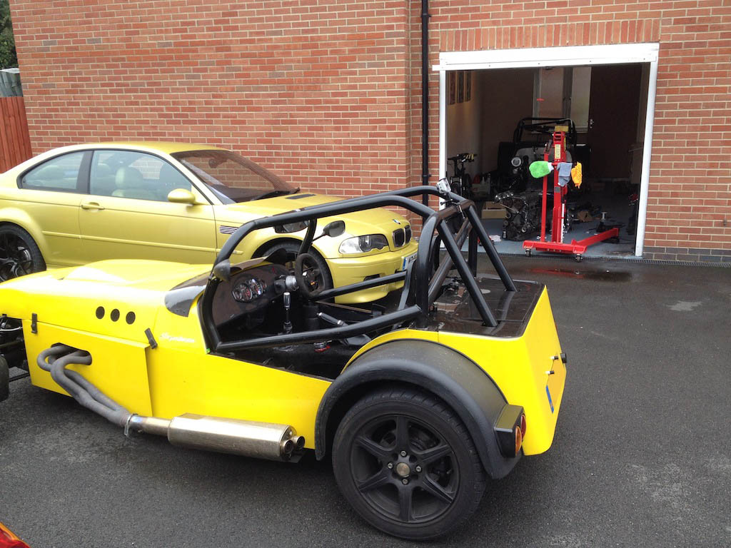

Great pic Olz....
We dropped from 7 x 15's shod with 205 50 15's to 7 x 13's on 205 60 13, the difference in diameter is negligible but we took 12kgs out
overall. We are using pro race 1.2 wheels which are available in all the usual et offsets and ford fitment. Noticeable improvement in handling as
well.
Regards
afj - thanks for the gen on the radius' and wheel/tyre options, will certainly be looking into them!

Proby - just a quick snap using the iPhone, not cracked out my proper gear & rig on it yet lol

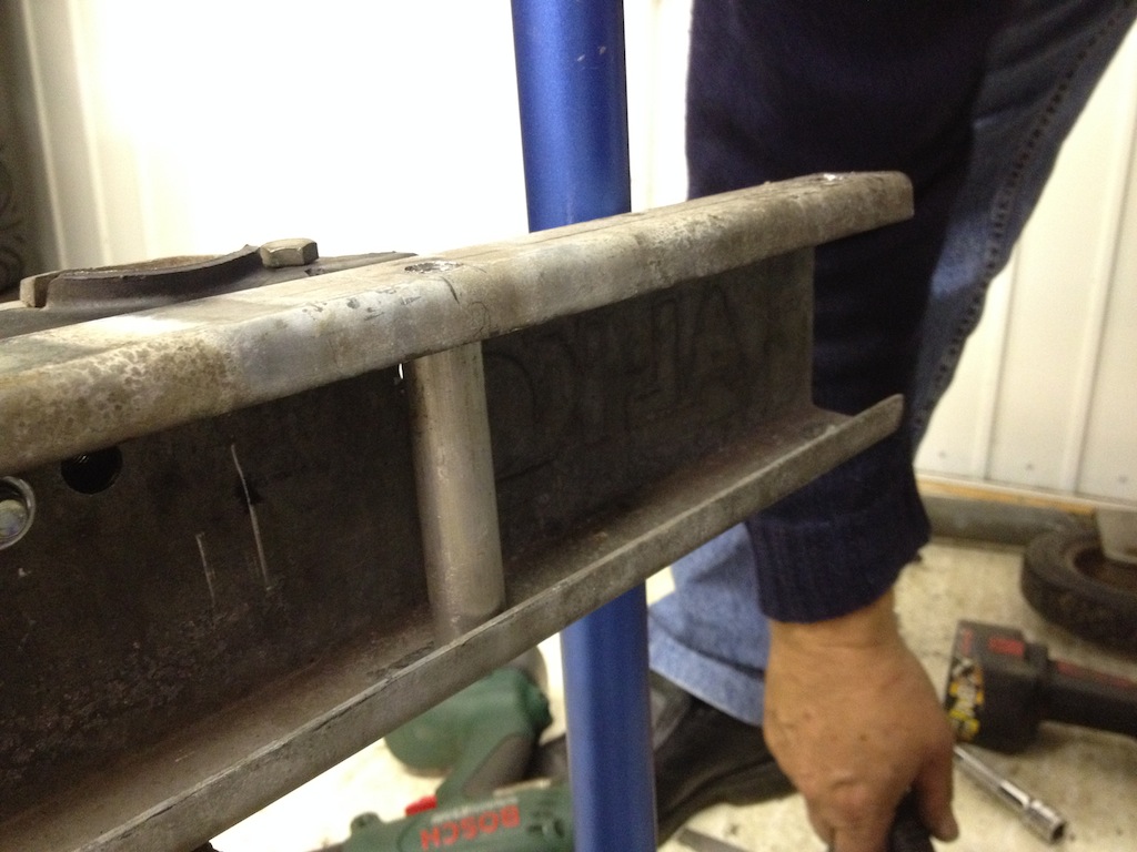

For now, I went down to B&Q, got 30" of steel tubing (£4.18), 1mm wall thickness x 16mm diameter, rounded the shoulders off two m8 nuts,
popped them in the ends and seam welded them, smoothed them off, popped the rose joints back on, and job jobbed... Car fixed... Just means for now I
have to use the clutch to change gear, ad no full throttle up changes!

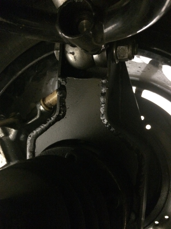

The supporting bracket that was operating/ holding the clutch arm into the gearbox stripped the threads out of the gearbox upon a hard 'rev
up' (it was in gear at the time, but clutch was depressed)
Rolled the car forward thinking it was proper broke to find an M8 nut (not snapped) with the last three threads being full of alloy... offered up the
bracket to put the bolt back in, and it was only held in by those three turns of the bolt...
So we got a longer bolt, and screwed it in the correct amount, whilst cutting a new thread into said gearbox hole.
Clutch pedal feels more solid than before now, not as much 'loose play' as it were... however it could be tighter with some of the sloppy
joints being replaced, in the near future

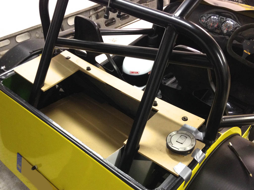

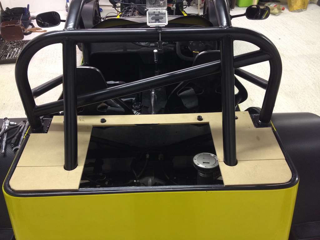

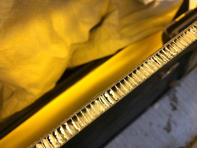

Decided to measure up and design my own MK Indy rear diffuser, so we got making a ply-wood template so its a constant continuation of the flat floor,
which will prevent the rear clam acting as a parachute slowing the car down under hard acceleration
Underside showing the continuation, large fins on the outside, slightly shallower fins on the inners to channel the air correctly
Larger out fins
Being made out of 1.2mm alloy sheeting, with folded outer fins, and TIG welded inner fins
Edge will be rolled and rounded to keep Mr.MOT tester happy, and to keep within guidelines, protrudes the rear of the car by 25mm

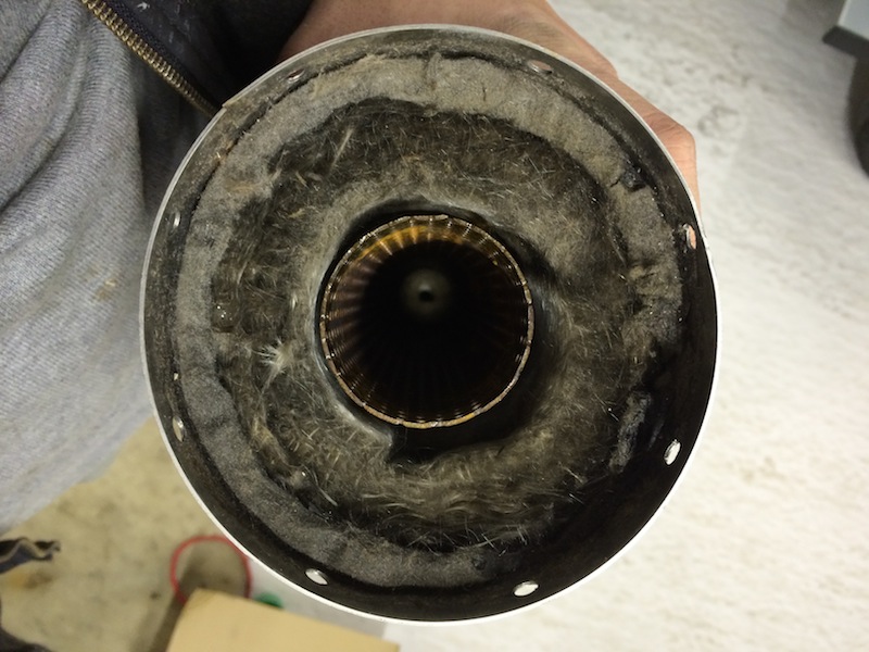

iPhone mic behind the dash completely exposed was still too distorted from engine & exhaust tone, so I cut some roll cage padding up, and wrapped
that around it to make a muffler for it, reduced it loads but still distorts under hard-loud-pedal

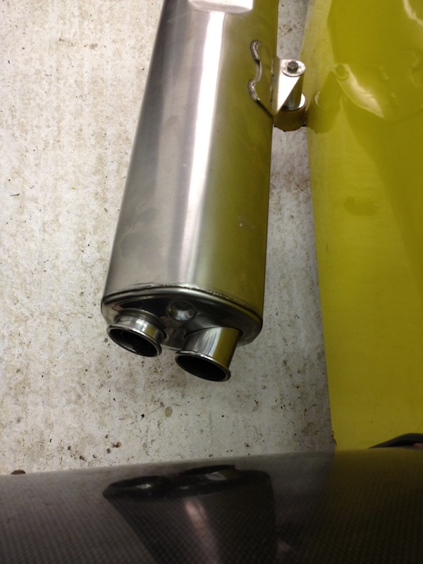

Removed, repacked and refitted exhaust to try and get it a little more quiet - whether its worked or not I don't know, maybe a larger longer can
would have been a better alternative, as this can is only 20inches x 4.5inches, and I think a new 22inch x 6inch would have done a better job

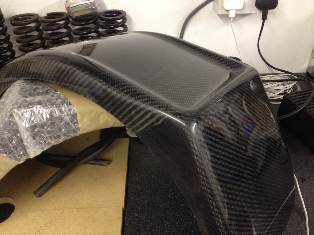

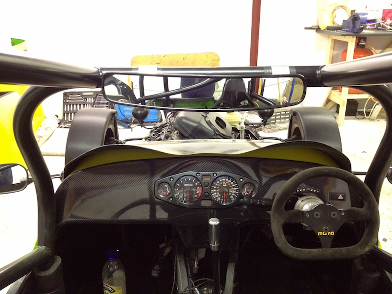

Took delivery of my new carbon aeroscreen today - any tips on how to fit it neatly?
measure up from the scuttle/side panel line on each side then tape in place, fix it on one side then do the other.
Ahhh nice one... didn't really think about it but my scuttle is stepped, but it doesn't matter come to think about it.
I've taped it on and sat in the car to see if any visibility is reduced and it's pretty perfect! My drivers seat is really low down you
see.
Had to remove my mirrors and then I'll plonk them back ontop othe sides of the screen
so on with the carbon aeroscreen that I purchased from Aerodynamix...
Removal of the old home made perspex one which has served its job very well!
It was a stepped scuttle type one
As per above advice, I taped it down to begin with to get angles and measurements
Rivetted on, following the curvature of the car
Didn't like the silver, didn't fit in with the colour scheme, so coloured the rivets black
All done
Very happy with my purchase - outstanding service from Julian @ Aerodynamix too

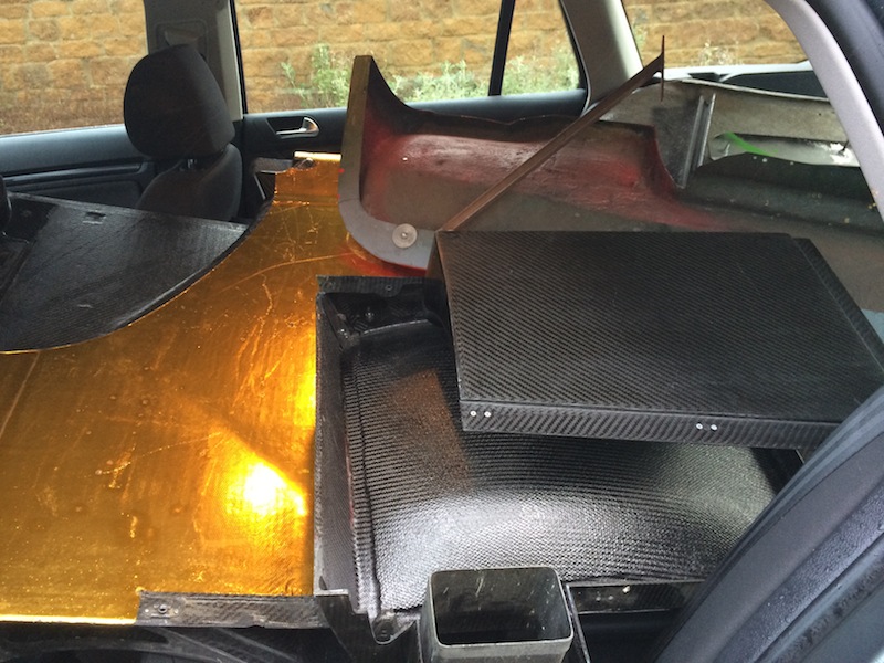

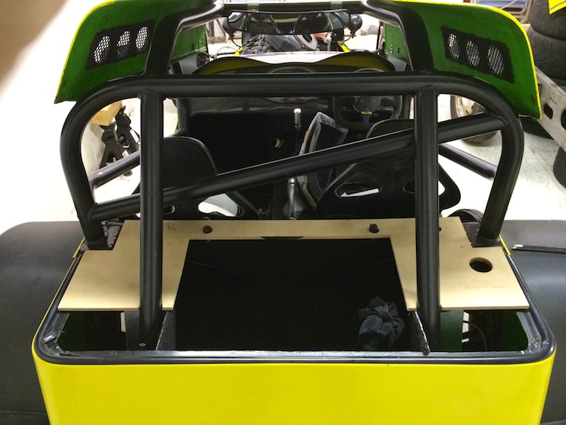

today we fitted the diffuser, and was very happy to see it weighing in lighter than some others, at 3.65kgs
this is just the prototype riveted version for now, will be sold one once the final templates are made
arse end up in the air, diffuser slid underneath
like for like comparison, open rear diff, and rear clam acting as a parachute
gloss black diffuser on, attached the the existing floor, and rear clam
Exits the car by 25mm, and rounded edges
Grrr
All done - now onto the next task

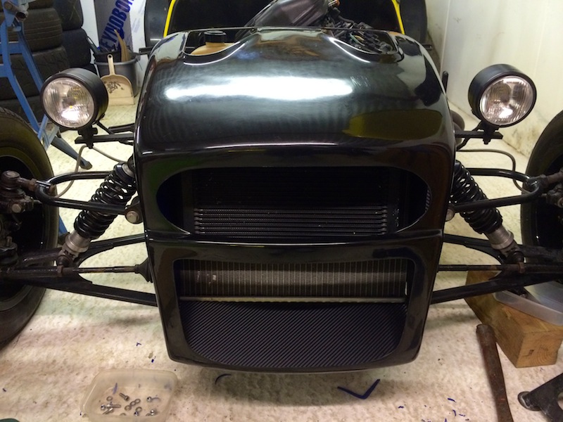

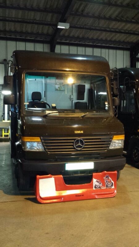

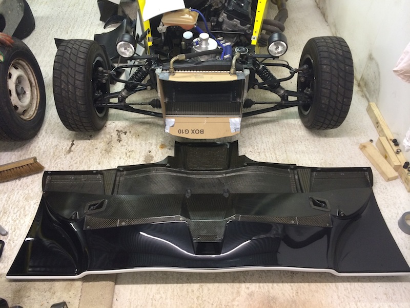

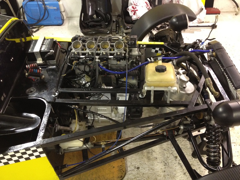

Set about making more aerodynamic changes to the car, so decided to look at the front of the car...
As it sits, completely open to the underside of the Busa lump
It's going to protrude the front of the underside of the nosecone by 50mm, and 60mm wider at either side (the shape isn't exact, it will be
rounded to suit the lines)
Jacked the car up to ensure front arms at full droop will clear even when air-born
The kick out/ change of angle - will not be a right angle, either rounded or smooth
The sides follow the lines of the wider gills at the side of the engine bay
Where the sump of the Busa engine hangs down, rather than boxing it off, I'll make an upside down alloy bonnet scoop facing backwards for better
aerodynamics and for hot air to escape if need be
Going to make it from 1.5mm alloy to keep the weight down
[Edited on 12/4/12 by yellowcab]
Are the marks on the bottom of the sump due to it hitting the ground?
If it is, I'd include a skid plate when you sort out the aero aids!
Cheers, Nick
Yep, there isn't much of the sump left lol - I will be looking for a new one in due course lol
Also, thats the main reason for the splitter, the aero benefits was secondary...

Spent some time this morning making the front aero splitter and engine under tray / sump guard... some photos of the progress...
1.5mm alloy sheet cut to cardboard template
once cut out - weigh it, 2.61kgs... nice and light
will attach to the wider gills of the side of the bay, and where the flat floor begins
Obviously the sump guard isn't attached yet - we were just making sure measurements were correct at this point
From the front of the car, looking back
Protrudes out 50mm, and 60mm either edge at the front
Flat floor from front to rear now...

It seems quite a lot of stuff is bolted straight through the chassis box section. Once you get round to stripping her down for a chassis refurb,
it'll be a good idea to weld crush tubes into these holes so you can properly do up the bolts without crushing the chassis members.

This bar that does nothing, other than hold the headlights...
Steel?! How heavy?!
1.1kg eek
Exact aluminium replacement, less than half the weight...
No need for the bit in the middle crossing the bay, nothing gets mounted on it, ditch it...
Thats better!
Now to tart them up a little, as silver doesn't "go" with the car...
3M Dinoc Carbon Wrap...
Refitted, another 909grams lighter... almost another kilo off...
Saving between the headlight stays, header tank bracket and the radiator mounts is already 2.315kg, not a great deal, but every little helps...

Thanks to the reminder from wylliezx9r, we cracked on with making the 'scoop' for the front aero splitter/ engine bay skid tray
Took some detailed measurements and worked out all the angles that were needed, cuts and folds
So you generally bend from the outside in, remembering which way to go, 25mm up, which will be rivnutted on, then 50mm down (the depth of the sump
hanging down)
Leaving a 135degree bend down to meet the existing metal
Nicely butted up
This is the scoop that will be facing backwards to let hot air escape
All done, was going to weld the angle, but there is absolutely no point, so not doing so
Rested ontop of the splitter, I will use rivnuts for this section, so I can get to the oil filter and sump plug without dropping the whole splitter
How it will look once on the car

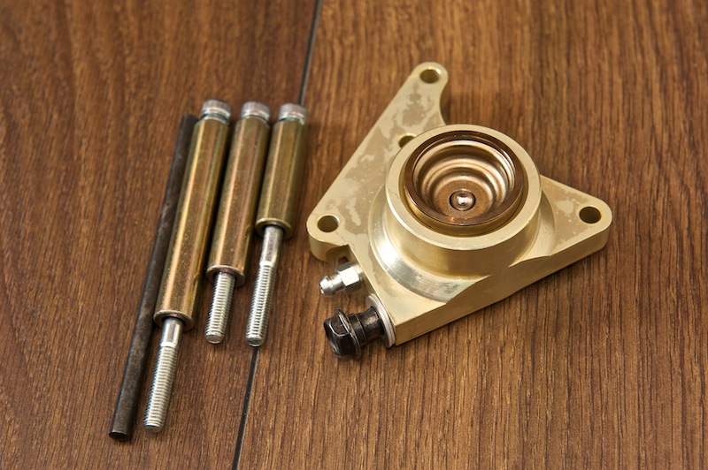

Long awaited and slow progress but well worth it, we have a finished custom article, yay!
Decided we didn't like the 'bolted on' look from the steering spacer to the Sierra hub, so we turned out the diameter so the spacer
would sit snug 'inside' the Sierra hub
Like so... looks like one unit
Two finished bits
We drilled and tapped 6 holes in the conventional holes if ever I change steering wheels
Total setup, with all bolts 1.673kgs, down from the original 2.485kg, thus saving 812grams, best part of a kilo, but please remember the weight was
secondary, and we could have made it with a thinner side wall, but at the end of the day, its steering the damn bathtub! So safety comes first!
Finished look, off the car - because its pissing down again lol

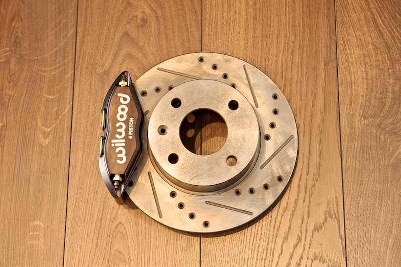

Cant see where to post about Brakes... doesn't seem to fall into any particular category - so I will ask the readers of my thread instead lol...
Will brakes that have been removed from an MK Indy with Cortina uprights, fit straight onto my Sierra uprights? or will I have to make some new alloy callipers brackets/ spacers?
They're Wilwood 4-pot calipers, 245mm drilled & vented disks and Mintex 1144 that have been removed from Jon Ison's MK Indy with Busa (I
think it's an Indy?)
Going new brakes for unsprung weight advantage of alloy calipers, will make up some new brackets then, just wasn't sure of the holes will be in
the correct place... :-)

Now we're onto them, here are the pics of said brakes from Jon

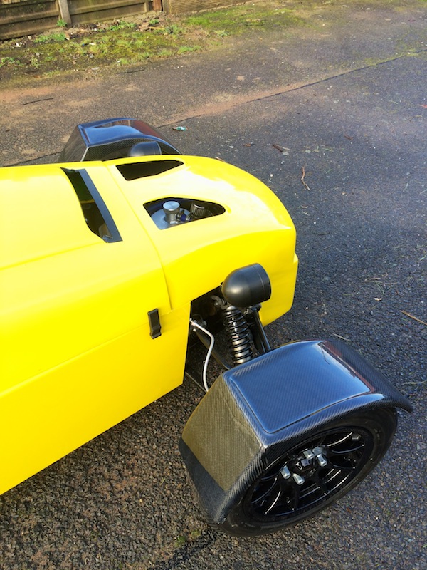

Got bored tonight so decided to pop out to take some photos...
[Edited on 2/5/12 by yellowcab]
pictures and keep up the good work.
Most weight saving thing i did was loose a stone and a half of fat !
Awesome pictures Olz, can I book some lessons please????
Your car looks great!
Looking at the 2nd photo above it looks like you`ve fitted eyelashes to your headlights!
Then I realised it`s just the circular bonnet vents in the
back ground. Have a look you`ll see what I mean
[Edited on 3/5/12 by snippy]
haha totally see what you mean, oh it does look very feminim!

Not much of an update, got the front aero diffuser / splitter powder coated, had it back today
Open under side before and after...
Side on view for those that sent me a message asking for one
Open rear end to let out hot air
Made the centre piece removable for oil changes, and quick fixes
Engine bay look in through OSF
Looking down towards nosecone & rad at front, from standing at passenger side
Offside, side view of flat floor from inside bay
That's all folks!

On a side note, thinking unsprung weight - 1x 15" wheel + tyre = 16.2kg, which means the set of four is 64.8kgs in total
Does anyone have the information of what both 13" Team Dynamic Pro Race 1.2 + tyre weighs... and a 13" Minilite + tyre weighs?
I'm pretty interested in the wheel & tyre weights too, it's quite easy to find wheel weights, but without the tyres it's meaningless for comparing different sizes.

finally after whats felt like years of waiting for planning permission, i finally i have a man-shack
no more getting wet!

hiya guys, sorry not been on much... been tinkering, not made fantastic progress, but its going in the right direction for the man-cave.
here are some pics so far... after spending ages at looking at RaceDeck, and Eva Anti Fatique garage floor tiles, and then picking myself up off
the floor when i worked out 30m2 of the stuff, I opted for smooth white garage floor paint
That was last night, so let it dry over night and really happy with the single coat that we applied, and it sealed the bare concrete at the same
time...
Off I pop to Wickes to take advantage of their 'Make Your Home more Energy Efficient' guff... 2x rolls of 100mm loft insulation
Cut into strips, to place in between the concrete ribs of the garage
Done... nice and cosy - already reduced / eliminated echo
So the idea was to 'no more nails' the plasterboard, to the exposed ribs of the concrete, but it doesn't seem to be working - so might
have to drill/ rawl plug/ and screw the plasterboard on
Wow, that is better than my house,...
lol don't you start aswell, already had the wife comment a few times on... "so when is the bathroom getting done?"
knackered, tired, cold, itchy...
hashtag/ihateloftinsulationwithapassion
couple of progress pics of partial plaster boarding, the centre piece left as thats where generator & exhaust extraction ducting will exit the
garage
walls will be painted white same as flooring
bit left to do - taking longer than i anticipated but I wasn't originally intending on following the angle of the garage roof
and my car fits in with plenty of space - yay!
finally finished... feels like it's took forever

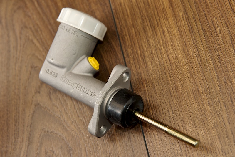

Update is, clutch is fixed and put back together with uprated clutch springs.
Feels solid, very bitey, and clutch pedal even more stiff than before now - but have been advised by Mike that I need to move the fulcrum down towards
the floor (pivot) point in order to get a easier pedal, and more forgiveness on bite point...
That's just a 'for now' until I get a new clutch MC...

most boring update ever - but i bought a 17" Longacre mirror, and got advised to make my own brackets, so I did lol
Not great, nor pretty, but it holds the mirror nice and secure... just need to file the undersides off to match the contour of the mirror sticky out
bits
these bits the lugs that hang down just need filing down
drilled a second hole in the mirror itself so it tilts slightly towards the driver, so i can see over my right shoulder
Like so... fitting it straight gives you lots of rear passenger viewing, but no rear drivers...
hashtag/thatisall
infact i'm going to remove the brackets, and make the holes elongated so i can pull the passenger side of the mirror out moreso

So I managed to find some crabby wheels with tyres to stick on the rear for hooning around as I don't want to send my R888s up in smoke, it was a
gamble as I didn't actually know what setup was on the car already... so bought these Borbets for £30 with 3 tyres
They fit, so thats a bonus, but only on the rear - the front cycle wings are so tight around the 195-50-15 tyres at the front, that these 195-60-15
tyres foul - that doesn't matter, just means that I will run crappy tyres to trash on the rear
Fit OK, 4x108 stud pattern, ET40, 6J 15
Gave them a clean up - and getting one tyre removed, and putting my Maxi Tarmac rally tyres on two of them for when I want some rear wheel grip lol

bahhh broke it again, but fixed it
seems the previous owner had hit the bottom of the rear near side wheel, causing the upright to fracture giving me major positive camber on the
nearside, and the correct negative camber on the offside... does anyone know where I can get a replacement rear upright?

So, it seems that the fracture in my rear upright may have already been there - but the trackday on Saturday certainly worsened it, I had a mooch back
through some old photos - this is what I found...
The day I bought it in January
About 4 weeks ago
Weekend before last...
Noticed positive camber at the rear at the track day on Saturday and found these fractures
Saturday evening, arriving home after track day
This evening, after tinkering with the car
My guess of +postive 2deg camber wasn't far out:
Offside rear looks fine, as it should, nicely tucked under
neg 1.5degrees of camber, cool
The rough surface, bumps, drifting has obviously made it more apparent, and we spotted it before it did any real damage.

On with fitting rear uprights, please point out if I've done something wrong...
This top calliper bolt hole here...
Looking through, you can see the shoulder/ weld of the upright, and its so close to the calliper bracket that you can't get the bolt in
straight...
Silhouette to show what I mean, granted I'm now using a allen headed bolt now so the radius of the bolt head is smaller, but it still fouls
I've ground the welds back, so it just passes through, but not particularly happy about it

First up was to offer up the dry sump tank, I presume this is the normal position to which it shouldn't foul anything obvious, I know its where
it sits in a Westfield, but presume it can sit in a similar position?
Took my old exhaust can off the manifold, and it was rattling like a bag of nails - all the old rivets that I had drilled out to repack it had
obviously fell inside, it now sounds like some kind of musical instrument... anyway - a new Aprillia RSV Mille can should make my car a little quieter
which is what I wanted

Went down the garage again for a couple of hours, stripped the rest of the front end of wheels, suspension, arms, brakes, steering rack etc so I could
continue refreshening up the chassis
Not very interesting, but pics nonetheless
One side gone
Couldn't split the hub carriers, from the arms for love nor money - so I removed them as is... however I do need to get the brake disks off, as
I'm replacing them - any tips anyone?
Freshen up continues, all mounting points now painted, and second coat applied to rest of the chassis
That's all for now folks, any help and advice in splitting the fronts would be greatly appreciated lol

Had my new replacements out the box that I got from Jon, and it seems that they're wrong stud pattern... the holes for the wheel bolts to go
through are tiny, and also look like 4x98, as opposed to 4x108, so looks like I'll need new disks...
Would use my current disks, but they don't fit in between the jaws of my Wilwood calipers - grrrr

New disk on left, old on right... ohhhh
Old disk thicker, and also hub carrier part deeper
PCD well off, and smaller holes

iirc, Jon's car runs cortina hubs, your using sierra, neither the calipers or discs will fit. The callipers may be useable with a fabricated bracket, but the discs, probably not so.
Chris you're totally right, and I now remember Jon telling me this - so I know its completely my error...
They're now up for sale for someone else to take advantage of

So the stripdown and clean up continues, and the wiring needs redoing whilst I'm at it - I'm sure I can shed a few kilos in unwanted wires,
and plugs that are just taped out the way!
On the MK, the bulkhead leading into the tunnel is curved, which, it might have looked pretty one day - or rather Ben pointed out is probably for a
Type 9...
You can see the grotty bulkhead on the left hand side, probably not as bad as it looks, just needs a good lick of paint
Here is a close up of the mess, the random holes which looks like a cross between a cheese grater, and a sieve... these were holding the gear shift
mechanism onto the bulkhead lol the clutch bracket is welded on as you can see, but it is done so as it enters the curve to the tunnel
I wanted to cut it off and replace it anyway, and get a Wilwood clutch 0.625 master cylinder with an integral reservoir, but my problem is below, the
master cylinder obviously has to exit the pedals and bulkhead at a 90degree angle, which means it cant be bolted straight on, also - the slotted hole
of where the old clutch pedal rod would also cause an issue.
Would you advise me just to get the angry grinder out, cut the whole lot out, re-weld a new piece in... without a curve... I'm aware i'd

Secondly - fitted the Clutch Slave Cylinder to the engine, so its another thing out the way

Also removed the fuel tank, high pressure pump, to measure up for a new tank
The measurements I have for the new tank is 19cm deep at the bottom, 12cm at the top, 40cm high, and 53cm wide... my concern with this is that it fits
snug under the lip of the rear clam, and I'm pretty sure I won't have enough height for the inlet pipe...
Hi mate, great thread. Do you mind me asking where you got your clutch slave cylinder from ? And how much ?
You can get them direct from SBD for £190 for the whole fitting kit, or Danny @ MK Sportscars for the same amount.
Extreme sell them, as do Nova.
I happened to get mine from a friend, it was surplus to requirements

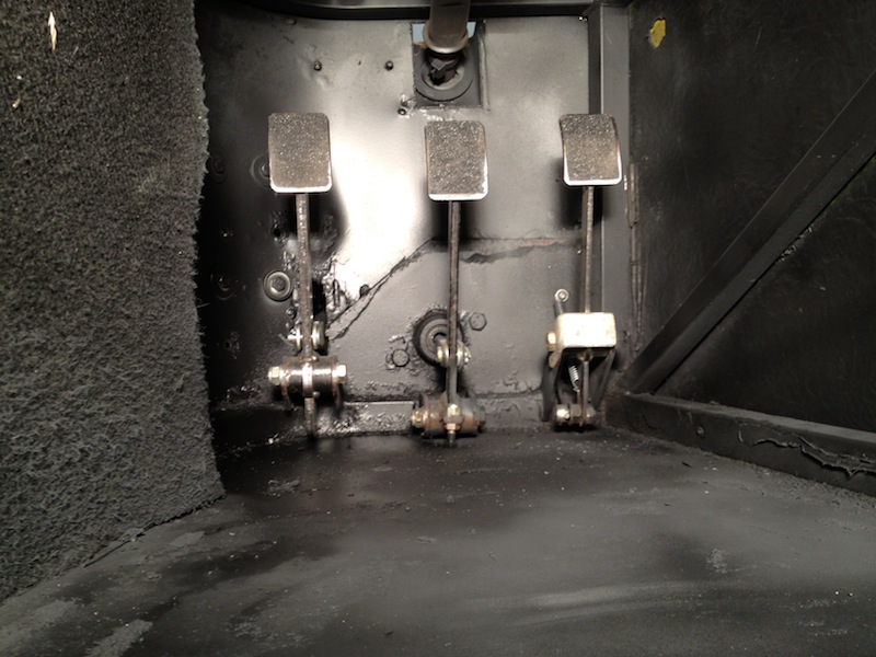

Anyway - the reason I wanted away with the standard clutch MC and bracketry was because of the 3 little rods, 4 rose-joints, and a pivot all might
have had the slightlest play in them, add all the bits of play up - and you get a sloppy pedal (ohhh errr) that together with the remote reservoir
that I wasn't keen on visually...
Searched eBay for the cheapest 0.625 Integral MC I could find, which was £24.99 free delivery, and this little beauty turns up, very happy - as
I've had CompBrake components before on previous cars, pedal box in my Nova, eccentric top mounts etc.

Continuing with that I had set out to do, I moved the triangulation bar down so the exhaust cleared nicely, and rewelded this back into place
This is how far it had to be moved down in order to clear
So I seam welded around the tubing making sure it got plenty of penetration - job jobbed!

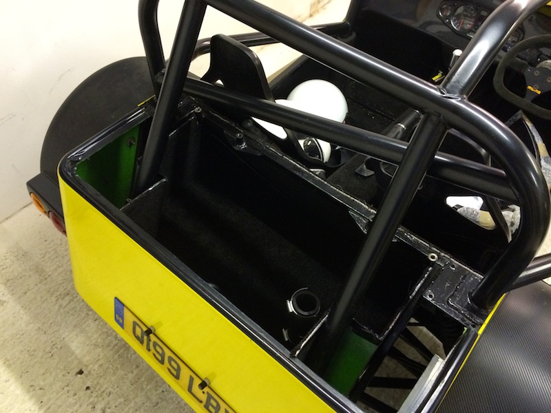

Just a small update really, put some grey primer on the front part of the chassis, to protect it before I come to paint it properly.
It was pointed out by Danny @ MK that I had welded the gear cable bracket on the wrong side of the car if I wanted to pull back to shift up, and push
forward to down shift - D'OH!!! - so on I go and make another bracket, and weld it onto the correct (passenger) side lol
Also, my rear calipers have been mounted upside down, thus causing the bleed nipple to be at the bottom, and a bugger to bleed... can I not just flip
them left to right, so they're at the top - and also, will the handbrake cable still operate OK?

I've had a custom fuel tank made by Jamie Start, a very talented ally fabricator based in Hucknall, Nottinghamshire
I bought a Suzuki Hayabusa integral fuel pump, sender & float
Sent it up to Jamie, for him to fabricate a mounting ring on the bottom of the tank, within a swirl pot
Tank being made with vertical baffles
Integral fuel swirl pot taking place, with a 14mm thick ally ring, for it to be blind drilled & tapped for the fuel pump to mount to
Dry fit of the pump, to be sure the float has free movement from top to bottom of the tank, without fouling the sides or baffles
Float at the top, and the gauge will read full... stops its travel about 20mm from the top of the tank
Finished article - very happy chappy
Nice snug fit... which means I can make some sort of boot for my camera equipment!

Whilst the POR15 chassis paint was out - I painted the bells and edges of the disks to prevent them from going rusty

Had my Aprillia RSV Mille rear can remodelled at the rear end so the inlet pipe comes out straight, which should quieten things down a fair bit...

Whacked the brakes on - just need pads & braided lines from Andy @ AB

Huge thanks to cosmick & Mike yet again - we have a 90% car which is complete.
We mocked up some ally brackets to mount the oil cooler so it would stand off the rad by 10mm...
Made four of, and riveted them together
Mounted and ready to be radius'd
Done, and onto coolant pipe work and neaten up, dry sump tank still to be mounted correctly
Dry sump tank mounted, and coolant pipes now in, header tank was in the dishwasher at this point.
Thanks to Mike who saved the day by using some vacuum cleaner metal pipework to extend coolant pipes so neatly
Horrid but very rewarding job of wrapping the manifold, used 19 metres in total
Scuttle area much more clean and tidy compared to what it used to be...
Coolant pipework neatened up too

13. New Wilwood 4-pot front callipers
14. New Wilwood Polymatrix E pads
15. New drilled & grooved solid front discs
16. New Compbrake integral clutch Master cylinder

Got a carbon dashboard from Danny @ MK, yet again amazing customer service, couldn't ask for better!

Couple of pics of the filler I bought from tank81, and also someone was asking about my exhaust, can & tailpipe angle, so here are a couple of
pics
Any idea what the fuel filler came off? Or what manufacture it is?
Suzuki Hayabusa mate :-)
Bit overkill on photos for such a simple job, but its the kind of photos I could have done with whilst doing it, and I couldn't find any,
anywhere, so thought I'd share how I achieved a simple (yet quiet satisfying) dashboard with Hayabusa clocks, sequential shift lights @ 10degree
angle LEDs, and a geartronics gear indicator, hidden, rather than ontop of dash...
It's all straight forward, but I enjoyed taking the photos along the way anyway.
I decided I wanted the clocks bang central to the car, and central top to bottom of the dash itself, so after nervously getting the holesaw out for
the steering column to begin with, I settled into just how robust the carbon dash is, they're not as fragile as they may look to begin with...
simple masking making it bigger than the clocks, so your jigsaw doesn't scratch the carbon
I've converted over to a single Renault Clio MK2 indicator stalk that does just about everything, and makes the dash look a lot cleaner, so I
masked off where the indicator stalk will be pushed back into the dash
Trial fit, everything clears, and can access the bracket that holds the indicator stalk in situ
All cut out - very easy to do, time consuming, lots of intricate filing to get it tip-top, but very rewarding
Next up is where to place sequential shift-lights, new geartronics gear indicator and hazard switch which is accessible and visible from the drivers
seat (with steering wheel on)
Most I've seen have just done it the way you would on a bike, and plonk it ontop of the dash itself like so, but I don't like the aesthetics
of doing so
Made a bracket out of ally, rivnut it, drill two small hole either side (i was contemplating tiger seal so nothing was visible, but I wanted to be
able to remove it, so had to compromise (dagnabbit))
Mark out window that needs removing, along with light sensor (as the display dims as the light fades)
Job jobbed... very happy with result, time consuming but well worth it, you can't quite see the light sensor light on this photo
This is my view from the drivers seat, can see the shift lights & gauge easily, the hazard switch is in sight incase of any emergencies, the only
smaller gauge I can't see without physically moving my head is the water temperature gauge which is hidden by the edge of the steering wheel,
nothing major... you can see the light sensor hole in this photo
A better/ closer photo
By the looks of this angle, I don't think the Go-Pro will be able to see the gear indicator, but thats not important lol
But you will be able to see the speedo and rev counter so it will look superb. The dash looks excellent just like a bought one.

Well done hawk eye, yes the drivers lower is set further back, rather than us dictating to the car that each rosejointed needed the provided 14mm
spacers either side, we did up the outer rosejoints on the back of the rear upright, as then measured to see what spacers we needed to make up for the
inboard so that they were all fitted in a relaxed state, an no pressure or twists was being put on the chassis, prior to doing them up.
With us doing the above, making adjustments is now very easy as the bolts just slide in and out by hand/ fingers without the need for hammers and pry
bars.
Don't get me wrong, initially we fitted the provided 14mm spacers inboard and on the outer, but it just became nigh impossible to get the bolts
through as everything was under so much stress... Also, the driveshaft didn't exit the diff at 90degrees either, as we'd have been forcing a
little castor on the wheel by moving it forward.

Ordered a pair of 195 15 15 Toyo R1Rs, to replace my rear Kuhmo Ecstas... It unlike me to sway away from 888s but I wanted to at least give them a
go... Especially as keeping 15s is only a temporary thing, so didn't want to be spending too much if I hope to pick up some 13s at Stoneleigh
I went for 195s for the rear aswell as front so I could chop and change, as my rears are 888s so I will be ale to make a direct comparison between the
two sets

Want to make a new boot panel, and boot space now the fuel tank has been moved down, should have some storage for bits and bobs...

Oh, another little something was to stop my car melting... some real carbon fibre riveted on should stop it, especially with a melting point of 3500
degrees lol

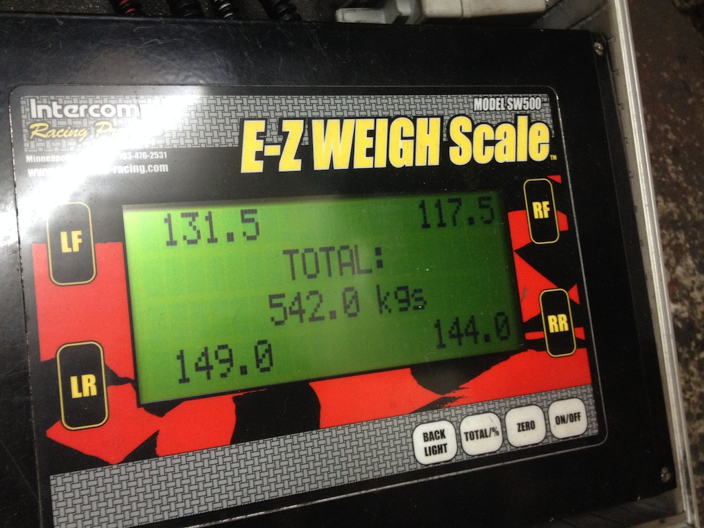

So the treatment my car had was the usual:
Front camber, castor & tow
Rear camber, castor & tow
Rake & ride height
Chassis measurement check from datum
2x corner weightings, once before and once after geometry adjustments
Pro-Tech shock dyno'ing
Wheel bearing checked
Tyre pressures corrected (oops)
Positive camber in roll issue rectified
As I had rosejointed the rear arms on my MK Indy, it enabled us to move the rear upper wishbone outer mounting point upwards along side the bottom
shock absorber bolt, which significantly reduced the amount of positive camber movement when in roll.
In it's standard position, when in 1degree of roll, I think we calculated that that calculated to 1.2degrees in positive movement (it did not
move to +1.2degrees, it just moved in a positive direction by 1.2degrees)
After we had moved the upper wishbone outer rose joint up alongside the bottom shock absorber bolt on the upright, it now reduced the amount of
movement from +1.2degrees, down to +0.4 degrees in a positive direction.
Obviously this is still not perfect, we would not like any 'positive' movement in camber when in roll, however, as above - for a very simple
move, this is the best we can get without having to grind, cut, move, and re-weld bracketry & shock absorber mounting points.
As my new static rear camber is -1.5degrees, when in roll, the outer rear wheel will now still have and remain in negative camber by 1.1degree.

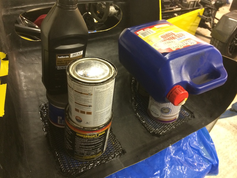

Next up is to make some boot space storage, just don't know where to start, unfortunately because my fuel tank is quite big, it will only be about 6 inches deep which is a bit of a pisser, but can't get my head around how to start it off
Ive got a couple of Tupperware boxes you can have?
Brilliant, thanks chum!
Have you not seem my luxury Tupperware boot box?

Wing mirrors on the car have always been useless, as all you can see is the rear tubs, so I went about moving them high up onto the cage
This is where they were originally, mounted on the side of the scuttle

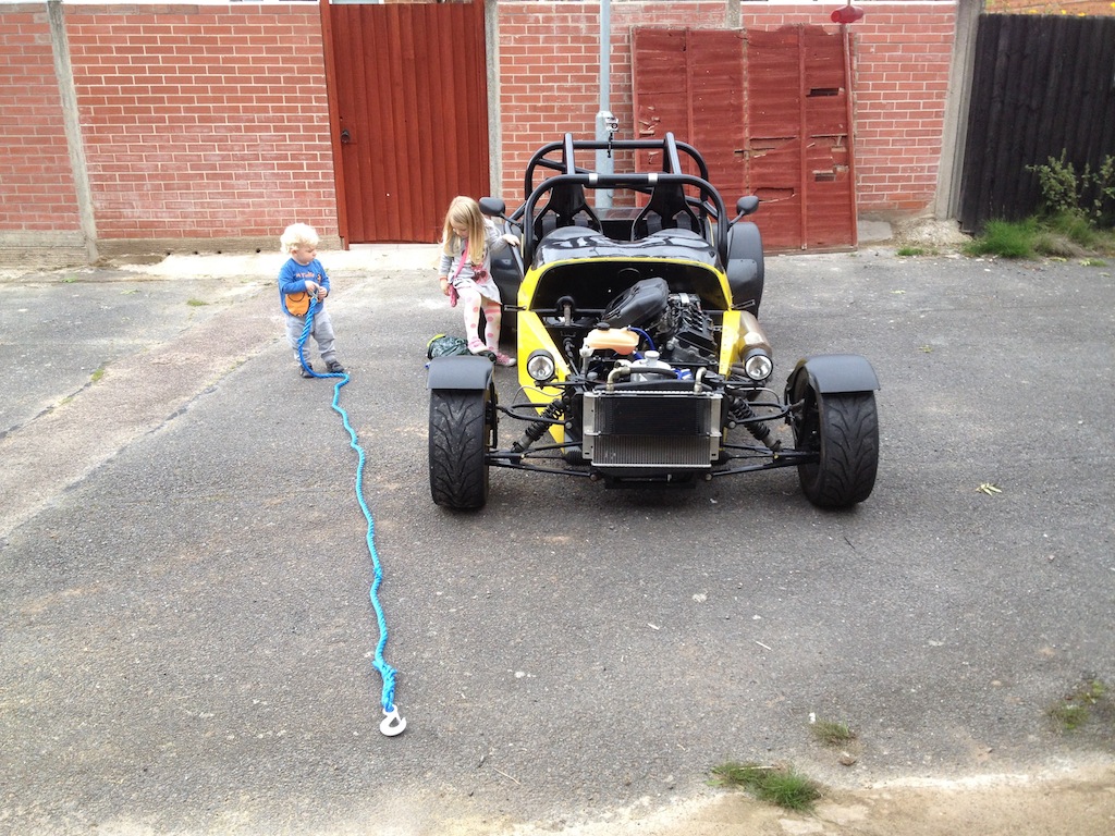

More help from my two mini's
"Dad I think you'll need this next time you go out"

Rear upper wishbone mounted up alongside the shock absorber inside the original upright
Weight:

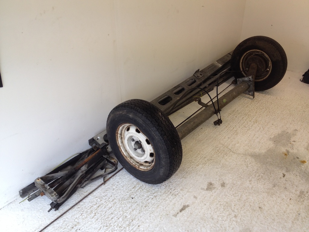

Decided I really need a trailer in order to enjoy my car at further afield trackdays - so I bought an Alko galvanised caravan chassis this morning,
which looked a right state.
Huge thanks to Colin/ReMan for helping me getting it back home, and thanks to cosmick for finding it for me!
Colin and I looking like pikeys trying not to get pulled over
All set for shortening/ customising and making it look pretty
In the process of making my rear bootlid a little neater as its currently shocking
This is a rather thick MDF version but not as heavy as it looks, but more than likely will be replaced with ally at a later date

I'm not über convinced your rear uprights are ideal in the 'post procomp' setup. Can I suggest a solid spacer and bolt in the hole
where the upper wishbone was, now it's up with the lower shock mount. Remember when you had the old upright crack, a spacer etc would stiffen and
provide support.
Either that or a redesign along the fabricated 'Haynes' route.

You're bang on the money with my rear upright, Matt @ ProComp had also advised me to put a spacer in where the wishbone used to be to maintain
the rigidity & strength, I'm the spacers up tonight!

When I had my car stripped down, I was talking to Andy Bates quite a bit, I asked about pedal box & bias, and we came to the conclusion that even
if I was to have the adjustability, you'd end up setting it in the standard 70/30 split anyway. So other than not spending unnecessarily
that's the main reason.
Good point about the pedal box, I just went that way because it seemed a quicker fix. (Not that it's made anything move quicker with my build.
Time and money are the biggest limiting factor)

So I took the trip up to see the lovely Jon Ison and nab his 13" Laser wheels & Yokohama A021R wets, whilst I was there I decided that I
needed some carbon in my life, so took them away too.
Got back home, and unfortunately wheels didn't fit as straight forward as one would like, despite knowing the offset was et19, instead of the
ideal et35, I thought with the rims being only 6J, I thought my current 15s were 7.5J, so I thought the difference would be negligible, however my 15s
are 6.5J - doh!
They 'appear' to bolt on, however they aren't - they foul the brake caliper, and even with 5mm spacers on (and losing the self centring
hub nut) they still caught
Offset being over an inch sticking further out...

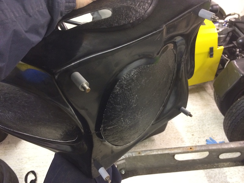

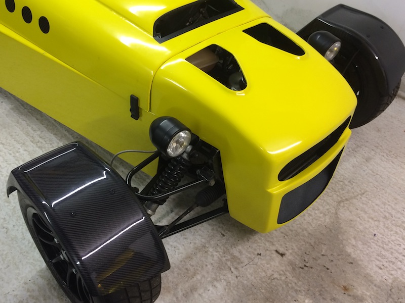

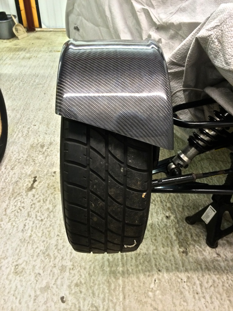

Carbon CSR front wings, the right ones this time lol
Oh hello cheeky, bit the bullet and bought new lol
Much betterererer
Clear with not alot of space, but a gap is a gap lol

I need new rear calipers anyway, as these have seen better days, but the hook that holds the end of the handbrake cable fouls the inside of the
wheel

Weight of a Caterham CSR 6x13 wheel with Avon CR500 175/55/13 tyre is 10.2kg (40.8kg all four)
This coming from my 16kg per wheel & tyre combo of the 15s, saves me a total of 23.2kg of unsprung weight.
Bring car total down from 542kg to 518.8kg unladen

Fronts fit OK, despite gappy cycle wings (due to be changed anyway)
Rears foul as expected, same problem as with the Pro Race 1.2s, the handbrake hook itself, not the spring this time

Great post but I would like to hear some feedback on your brakes, from what I see you have standard Sierra rear brakes and master cylinder and Wilwood
Powerlites on the front.
How do they perform in stopping power and feel?
Does this get rid of the wooden feel with standard sierra front calipers?
Yes hugely - going from the Sierra fronts, to the Wilwoods was probably one of the biggest physical 'feeling' changes I made to the car.
Despite not having a bias setup, it brakes incredibly flat without any particular wheel looking up prematurely.

Colin - I took your advice and got spares lol the slightly shorter set are 200/50VR13 which are a perfect fit for anything between 6J and 8J wheels
Let the chopping any changing commence, only took me an hour to remove, strip, valve, refit, inflate & balance all 8 wheels, and dispose of 4
tyres, and bring home the 4x bare Laser alloys
These are my two dry rears 6J Caterham CSR wheels with 200/50VR13 Yokohama Advan a005
Wouldn't fit on anything less than 6J
All loaded up for the journey home
These will now be sold on

lol cheers, last night I popped down garage, removed rear calipers as drivers rear was leaking, to find that handbrake mechanism had been locked on
the drivers rear clamping the pad to this disc permanently, and the pads hadn't been located on the piston of the caliper correctly so
wasn't using the full pad, just the outer edge, I'm now mildly excited at the thought of being able to stop.

Removed the fuel tank to replace it with a Caterham race fuel bag which didn't fit, so putting my ally tank back in, but not before making a boot
box and new boot lid.

As above, I removed my rear calipers in hope to replace all the seals in them, but they're pretty bad, so decided to cut my losses and buying
some new reconned ones from BigReddRacing from eBay, and these will go back to them as a part of the deal and £100 cash back
Here you can see the small amount of disk that was being used because of the pads not being located on the caliper piston correctly
Thought I may have had to replace the disks aswell, but upon removal there was no signs of wear, no hairline cracks and more importantly no lip on the
edge and the thickness was still that of new, so I cleaned them up and painted the bells

Hiding under the towel are the wider 245 slicks that are for sale, the fuel tank is sat ontop, as they was out to try the Caterham fuel bag which
didn't fit

However, in my defence (excuses already) I have a rollcage to contend with, which makes it an arse of a job to do - as the floor of the box will need
to be 2-piece, as it will not fit as one single piece.
Secondly, I wrongly had my fuel tank made slightly too tall (being greedy on the range per tank), which means the floor of my boot will be stepped, as
it will go down about 2 inches when it goes over the diff (and incredibly shallow over the tank)
Thirdly, need I go on? I will anyway, my fuel filler (due to poxy cage again) is way more central to the car than yours - so I dunno what to do about
that either
Now, enough excuses out the way - feel free to chip in at any point during me trying to make it lol

Replaced standard spring for RJK350 ones
Ground down handbrake mechanism hook, to make more clearance
They look nice at least, disks painted, callipers on, shortened springs fitted, handbrake 'hook' ground down a little, handbrake cable
clevis ground down a little
But they still foul the stick on slim wheels weights, so in frustration i just ripped the weights off so they fit... but obviously thats not the
answer, I forgot to bend the handbrake hook down 5mm, to clear, I'm not even sure bending the hook down will make the spring clear anyway - will
it? - doh!

Thanks for the advice on the brakes pal, I'll be sure to scrape it off
Caterham tank is a big 35litre bad boy, internal pump, long and shallow, but my cage legs are too narrow for it to fit
So finally bled up new brakes and pedal is now firmer than ever, so looking forward to bedding them in and having some decent braking power at last,

Next up, fuel tank is back in, straps have been relocated to the front edge of the tank, so my boot box can be another 1.5inch deeper, and the ally
neck of the filler has been cut down, so the bend on the rubber filler can start lower down
This is what I had to work with, and the space
The MDF is now only a template, and it will be made in ally now I have found a supplier of some free bits
The opening or 'boot lid' cannot be made any wider, as my rear rollcage legs get closer together the further up the cage they go - so should
I have the opening wider, the boot lid wouldn't be able to open all the way
Started out by making a template for the floor, originally I was going to have it stepped, but decided against this as too much faffing, for zero
gain
Added some extra bits on on the front edge, so it could sit on the bracing of the rear bulk head to its sitting on a shelf
I was going to incorporate the rollcage within the boot, but then felt it'd look stupid, and leave the floor gappy around the rollcage legs
The side walls of the boot box, will be riv-nutted to the bracing, which dictates to me the width of the box
I have not got the patience, skill nor engineering ability to do a "Legend 40inches" 'cubby hole', so this will have to
do
So after a while of working out angles, measuring, measuring, getting it wrong, more measuring, cutting, taping, cutting wrongly, taping back up, I
decided to box off the cage legs, so when you look in the boot, they cannot be seen, this took longer than anticipated, as the boot gets shallower the
further towards the rear clam it gets, so the angles are always changing & reducing
You can just see the diagonal bracing its being fastened to
Next up is the filler, this will have to enter the boot box, but its no great shakes, I just want it to look as nice as possible, so the filler is
going to be on the outside of the box, and the rubber pipe will enter the side of the boot, and exit the bottom, this is a compromise due to the size
and shape of the fuel tank that I had made
The side of the box has been slotted so we could remove the fuel pipe and fit it easily, but in the ally version there will just be a hole for the
fuel pipe to pass through, once its found its natural angle
[Edited on 23/11/13 by yellowcab]
Be careful of having bends in the fuel filler pipe. You end up with clicky fuel pump syndrome mate
Try to keep the pipe as straight as possible.
The decision to have the filler on the outside was because I didn't want to have to unlock the boot lid, then to unlock the filler just to fill
up with fuel - but this may be quicker than having clicky petrol pump syndrome lol
The photos above are a little bit misleading, as the rubber hose is actually too long at present and will need cutting down, which will reduce the
kink a little, and also, how about if I move the fuel cap itself over moreso, so its as close to being above the tank as possible, will that help I
presume?
Like so...
I suppose I could have the filler inside the boot box itself, leaving the top looking flush... you think i'd be better off with that?
Ignore that idea about moving the filler cap more inwardly - I cannot do this due to the diagonal bracing under the bootlid.
Balls
It's either, put up with slow filling at the pumps, orrrrrr having the filler inside the box itself
Fix it so you can drive to the petrol station and try it out!!!
Can't really get that far, it's SORN, and by the time I've made the boot box - I wouldn't want to then change it.
I'm just gonna have to make a decision and stick with it, lol
Not down the shed anymore, but having looked at this photo, it can be moved over a considerable amount
Move it over as much as possible and keep your fingers crossed. It might be ok as there's not a big bend in it
Put the filler where mine is?
I had mine in the rear panel with a metal bend to connect it to the tank. No real problems filling up, just could bot go full speed once it was almost
full.
You can just about see the filler location here: ;-)
This is actually a better shot. Boot box was very similar to yours.
You won't have a clicky problem with the vertical filler even if you put the dogleg bends in it
Its only on the back panel like mine that it can be a bit slow, but then it still depends how the bend sits, I live with mine OK
Just got back from being down shed again, and opted to have the filler inside the boot box itself.
The pro's of having a straight piece of pipe outweighed the cons
I like the fact it's currently straight so I can see directly inside the tank to see how inch fuel I have in, even when my fuel gauge reads
empty, nothing beats physically being able to see how much fuel you have in it.
Secondly should the pipe work have a kink in it as drastic as mine was, the petrol pump would only cut when the fuel hits the nozzle, by which time
the rubber pipe itself will have fuel in it, which is liable to then leak into my boot, not keen on that idea.
There are no real cons to having the filler inside the boot itself, it doesn't take any more space, simplicity is best for me personally.
Not for everyone, some might not like the idea, but suits me
You can have the filler pipe straight without the filler being in the boot. Fit the filler cap on a bracket on the back edge of the back panel and cut
a horse shoe shaped piece out of the boot lid to clear the filler cap
You are doing a good job, take your time and do it how you really want it to end up, you don't have a time limit, winters on it's way
This is how Hellfire did it:
Finished Boot
You can do it with the split boot lid.
[Edited on 23-11-13 by 40inches]

A couple more pics of when I popped back down, you can see how much the side panels evolved from our very first cuts, but taking this time in the
templates will hopefully reap benefits within the final ally product fitting perfectly
A lot of messing, fettling - but like above, I'm under no time restraints, so it'll take as long as it takes
I chanced it and hoped that the passenger side would be a complete mirror image replica, so all the time it took doing the first one, paid of even
further, I drew around it, obviously folded the other way...
Low and behold, first time, snug as a bug in a rug!
Starting to take (slow) shape now, happy with the size, depth and general finish so far of the templates
Used a piece of 1mm angle, 'sat' it on the rear bulk head bracing, and rivetted to the diaggonal, this will support the edges of the floor,
and give something for the sides to fasten to
Thats all for now folks
Like !
More boring boot progress, but incredibly satisfying nonetheless, 40inches is totally right, taking the time and being a perfectionist really does the
make the job rewarding

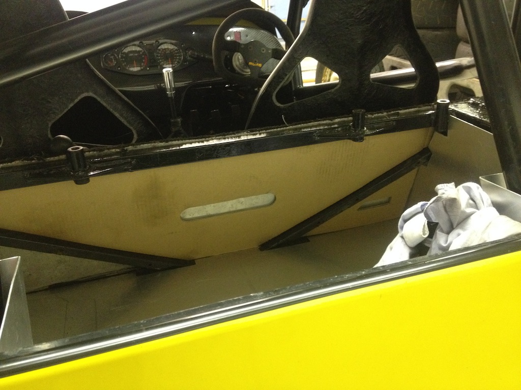

So the cardboard template was spot on in terms of size, so I drew around it onto the aluminium sheet that I got FOC, and hole cut the filler hole,
and the breather hole
Then cut the sides out of the ally using an angle grinder, alot easier to get die-straight lines over a jigsaw (in my opinion lol)
Tried the boot floor in the car, has to go in a certain way due to rollcage legs, but ones its mastered, its easy
Butts up nicely to the rear bulkhead, and sits onto of the angle
Then removed to de-burr the edges, here is the template for boot floor and sides
Next up to fold the sides, using a clamp and a vice to get a nice straight edge
Being sure not to bend the further most back bend first, otherwise you cannot then get it in the vice to make the further forward bend, you end up
with something like this, drivers side done
Just slots in place, I've decided that each panel will be individually carpeted first, then fastened in, so you'll see the head of the bolt
holding each panel in, but that suits me, so should I need to remove them to access shock absorbers or remove the boot altogether, I can do without
having to rip off the carpet to access said fastening bolts
Passenger side was just as easy as the drivers
This is where I left it for today
[Edited on 24/11/13 by yellowcab]

Slow progress on the boot box, as started building the trailer with Mike
To add stability to the box itself, I riveted some angle so the sides met the floor
Next up, trailer goodies
Removed 3ft from the back of the trailer, and 3ft off the front of a trailer, making a 21ft caravan, now a 15ft trailer, from tow-hitch to rear
Swapped the positioning around inside the garage
Made up some crush tubes, so the trailer will pull straight, and no drag to one side, some 100mm bolts will pass through this section, straight
through the tow hitch
Here is the basic framework, whilst the rest of the 3mm galv is being cut & bent
Will need a long jockey wheel, wheels to be painted, and the rest cleaned up but you get the idea

So my new Donkervoort nose cone that daveb666 picked up for my 'felt' light in comparison to my current one.
Not exactly a 'fair' weighin, as my current yellow nose has mesh on it, and the small indicators, but still interesting nonetheless, current
nose cone - 3.6kg
Then my new item was too light for the scales to recognise, so had to weigh something heavier then minus one from the other, 16.5kg - 18.1kg = 1.6kg -
so less than half, happy with that
Not fitted at all, as needs trimming to fit around oil cooler, but its just offered up for now

Really like the look of the new nose-cone, especially with the top vent holes. I need more vents in my life I think.
I concur!
More vents, less weight, win/win.
(until you add mesh) LOL
Its good to see my old Donkervoort nose cone being fitted to a MK at long last, looks the dogs dangles
Yes Paul, it finally goes on a car after being passed around, for what, 6 years did I hear?
It's sooo light too, it needs a few tweaks, but I'm confident it'll look awesome when in place.
Its a marmite nose though, some will hate it, which is the main attraction for me

So todays objective was to try and get the Donkervoort nose fitting nicely.
A time consuming job again, as its a lot of fitting, marking, removing, chopping bits out, refitting, remarking, realising you'd done it wrong,
trying to correct what you'd done wrong, re-removing more stuff, and repeat... several times... over, and over.... and probably over again.
The annoying thing about photos, as the first one below shows it just resting on with it not fitting at all, no where, with no modifications done to
it... and the final result, looks exactly the same lol
This is it just resting in place whilst I marked it out for where it fouled
First off, was my home made oil cooler brackets that I made to make the cooler stand proud of the radiator needed slimming down, as the new nose at
the front is slightly narrower than the original item
How they were made to begin with:
And how they needed modifying to allow the nose to fit on snug
In order for the nose to fit nicely up to the box seciton, space the for two front lower wishbone bolts needed nibbling out, aswell as the the
headlight stay bars
Fast forward several faffing and hours, and here is the (semi) finished article
You'll notice that where the back of the nose, meets the bonnet, it needs pulling out slightly, but thats no biggie
Job jobbed, just needs black mesh & wrapping... along with the rest of the car at some point lol

So more fettling with the new nosecone, where the nose overlapped the wider ally panels of the engine bay, the nose cone obviously lifted off the
chassis box section, leaving a slight gap that I wasn't chuffed about, so I marked and cut off the overlap, and cut a section out so the nosecone
sat flat agains the black box section
This obviously left the whole bare where it was being mounted to, excuse the rucked up wrap lol
So I 90degree bent some ally, and put a little return fold on it so it folds around the ally panel nicely leaving no sharp edges
Offered it up, and put the original finger bolt back in - looks alright
Same goes for the other side, just need tigersealing in place, as I don't want any rivets seen on the outside as it'll show under the new
wrap

So the job in hand, front plastic cycle wing swap over to Carbon CSR style ones...
This is the carbon one sat on top, again, I may aswell say - here you go, job done - as this is pretty much what it'll look like anyway lol
I'm actually going to miss the harder looking plastic 'dry-look' carbon wrapped ones, as they're not as pretty, they look more
mean...
Here is new & old side by side...
First off, operation cover up, I've learnt my lesson with grinding fibreglass away and the sheer amount of dust it produces!
Once removed, first thing - weigh them... 1 plastic MK cycle wing guard is 867grams x2 = 1.734kg
One new carbon CSR cycle wing is 455grams x2 = 910grams (total saving of 824grams, another kilo near as damn it)
Here is the new one offered up, and how I tend on fitting it - but could do with some advice...
I presume the idea is to have the 'flat top' as horizontal as possible (obviously when car is on the ground)
They will be Tiger Sealed on like so
Would you say this is enough, or too much clearence over above the tyre itself, it measure about an inch
From the rear, and side they look OK (dont forget front end is in the air, hence top of CSR wing not horizontal)
But from the front, they seem to be too far inward, would you have the tyre mounted centrally? or off centre, and why?

Back down on the wheels, carbon cycle wings just resting on the stays as I have no tiger seal yet, and I want to be sure they're fitted correctly
so need some advice before I do so
This is about as horizontal as they can get, I cannot roll them forward anymore as the back lower bracket is already on the bottom edge of the cycle
wing - is this enough? or would you advice me start chopping & re-welding the brackets?
New front end is starting to take shape slowly... I think I'm liking the look

Youll still be able to take some off the rear part of the cycle wing, only problem is the stay is at a low position:
5.2.6. With the exception of racing cars or cars of
periods A to D be equipped on all wheels with
mudguards which present no sharp edges and cover
the complete wheel (flange+rim+tyre) around an arc of
120 degrees. This minimum coverage must:
a) be achieved with a continuous surface of rigid
material within which ventilation louvres may be
fitted. The tyre must not be visible when viewed
from above. When viewed from the rear, the tyre
must not be visible above any point 50mm or
more above the axle centre line
This might shave some weight of , but you axle line compared to the bottom most part of the wing might be near this already?
Edited: you might find with the lack of support at the front you get vibration, can you swap each wing stay over from hub to hub, i.e. right one to
the left and left to right, this would mean you foremost stay would be at the front of the wing and the rear most would be at the square part. The
flatter the top surface in essence the better the air flow across it will be, and the less turbulent it will get behind the wing.....just think banned
Volvo Esate in the touring cars, its square shape gave it less drag.
[Edited on 6/1/14 by sam919]
Don't they want rolling back further anyway.
The more guard at the back th better.
MNRs are not just for looks!
After a bit of mooching, I searched Google Images for 'Caterham CSR'
It seems the flats want to be completely horizontal, unless anyone else knows different?
Sorry Colin, didn't see your reply.
I'm not familiar with MNR cycle wings, do they have the aero flats on too?
I set mine up with a spirit level along the top, they do hang over the front a lot, but I think it looks ok that way. I will be fitting
some mud flaps though, stones hit the rear arches above the stainless guards.
Don't know if it makes any difference as regards aerodynamics, but that's how Caterham fit them, notice the extra large stone guards.
I'd set them up flat as per the photos, but that does leave a large gap at the rear so prepare to get wet/stonechipped.
I prefer the ones in the link above that show the full wrap-around arch at the rear.
I used to have some mudflaps hanging off the back of my old ones, but removed them, think it's because they scraped the floor and annoyed me
lol
I'll fit them rolled as far forward possible to make flat top spirit level horizontal, if i get battered with stones and soaking wet, then I can
always rivet some mudflap material onto them at the back
Oh regarding the left to right fitting (when viewing from the front)
I'll fit them so my widest slicks fit comfortably, at least that way I know both wet & dry setups will have no problems

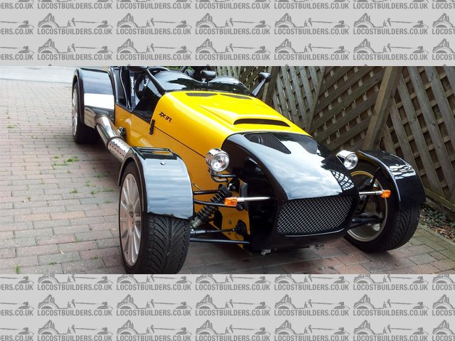

Horizontal on the flat and as close as possible. But in the end it's what you think looks best. I've hung rally mudguards from mine as the
tyres kick up so much crap I was getting covered, now it's not so bad but still get a few stones.
Sure whatever you do will look fine

My new nose cone has two holes at the top which will aid in getting rid of the hot air, and less parachute effect.
Will buy some foam for either side of rad too (as per doc) to divert all air through it

This is my plan for duct, rather than vertical faces that could cause buffeting, I want some sort of flexible sheet (PU, thin rubber) that can
effectively skirt the inside of the nose cone and give an (almost) velocity stack style entry to the rad.
Radiatorduct
[Edited on 9-1-14 by loggyboy]
PU foam covered in duct tape would be ideal for this (race car seat style)
That would work, i did plan on having it loose in the nose cone so it could be slid on and off, but If you formed it in to the nose cone then it would be just as easy to gain access to the front of the car.
Lovely carvable stuff with a sharp knife too
We used expanding foam on ours. We made a template for the nose cone and a similar one for the radiator and then boxed it in using MDF before wrapping
in cling film and filling the void in the nosecone with expanding foam. Once dried, remove the MDF and job done.
Phil
Cheers for all the advice & experiences chaps - I've today bought a can of expanding foam, so this poo could get messy lol

The front cycle wings, I didn't like how off-centre they were due to the big gap inboard (over an inch clearance on the wing stays on the wall
of the tyre)
Aswell as the overly large gap on the tyre treads
Whipped my wet wheels off, and stuck on the dry Caterham wheels, with my rear slicks (as they're much bigger than I'd ever expect to run on
the front, but just incase I come into strife, I could always stick one of these on with clearance, to limp it back onto trailer etc)
First of all, without moving the cycle wing stay main tubular section, I bent in the 90degree part to get it a little closer, but it didn't
really make a great deal of difference to how far it sat away from the 'tread'
So I bent the tubular section in a vice, and kinked it towards the inner tyre wall so my carbon arches could sit outer more, and more centrally to the
tread, straightened out the flat section, and re-curved it around the tyres profile
But the wing stay was too long, it came too far over the tread, leaving the cycle wing itself sticking up towards the outer most edge, like so:
I cut them down so they sit nice and flush and evenly across the thread
Got them back to bare metal ready for powdercoating or painting
Nice and close with a 2-3mm gap (on the biggest wheel & tyre combo I have)
So I will be drilling, tapping a thread in the flat section, & grub screwing with thread lock as there is not enough room to put a nut on the
underside... this will make my tops removable, as its so much easier to remove the cycle wing stays with the top removable, otherwise if I Tigerseal
bond the tops on, you have to disconnect brake lines & wishbones to remove cycle wings otherwise, which is a faff
Just to re-iterate... the car will not be driven in anger on the above front tyres, its just to get me out of trouble when pushing the car around
Oh, and because I want to tinker with aero stuffs, I've bought an aero front splitter like this so I can pop it on for trackdays
And a half width nose cone, instead of the connards

You might find them too close, remember the tire will expand quite a bit and centrifugal force will push the tyre out as it rotates. Slicks like those
should be around 18 psi cold a few times round the track then all set to 21psi, if your using air, but they will get slightly bigger none the less.
The cycle wing will also act downward probably pushing the outer edge closer to the tyre as well as there is more flex towards the non support end.
Another thing to bare in mind is trying to get the wheel on and off, if the stay/ cycle wing is too close the outer edge of the cycle wing wont allow
the the wheel on, you can fit them all in place then use a air sander to shave off under the outer edge untill the tyre fits, you do end up with much
less cycle wing than you started with when your trying to get it as close to the tyre as possible without fouling.
Remember with the front wing in place generating downforce the rear will become lighter so you might have to think if you havent already about
stiffening the front up, this will then generate understeer in lower speed corners it all becomes a trade off ......as with more aero, the lower your
top end will be.
Worth an experiment none the less
That's why he put this ;-)
I thought that was in refference to tyre condition, rather than tyre profile.
Yeah Ben is spot on.
I'd never run these tyres at the front of the car, as the equate to something like 215-65-13 or something daft.
Nice and close with a 2-3mm gap (on the biggest wheel & tyre combo I have):
This is why i mentioned it.
Gotcha Sam, it's more for me pushing the car around, on and off the trailer and around the workshop, didn't want to become a time where the
wheels didn't even fit on, hence why I used these as clearance wheels, all my other front wheels are smaller in circumference.
Front wets: 185/60/13
Front dry: 175/60/13
Rear wets: 205/60/13
Rear dry: 215/65/13 (slick equiv) (the aboves)
[Edited on 12/1/14 by yellowcab]
These are my dry fronts fitted with the old cycle wings, where the original gap on the big slicks was about an inch, you can see on my proper front
tyres it's about 1.5-2inches, so now with only 2-3mm clearance on my big slicks, I have a feeling the gap will still be too large on my proper
fronts

Oh - before I forget, here is a short video clip of the gaps I have inside my nose cone, whilst fitted, around the bottom, sides & top of radiator
and oil cooler...
As aerodynamics go, I know its important to let the air escape through the top of the nose cone, so I'm not wanting to blank that off, but would
you guys say it was worth me doing the bottom and sides, or not really?

Not a very entertaining update unfortunately, just more fettling with the passenger side cycle wing stay... and of course it didn't go to plan
So despite the cycle wing stays being rather close the the tyre tread, it still 'appears' that they sit miles off the tyre once they're
going to be fitted...
21mm to be exact at the front leading edge
Nice and close to the inside tyre walls which I wanted
So to now show how much more clearance I have with my 'correct' front wheel & tyre setups, here are my wets - Yokohama A021R 185-60-13,
with around 6-7mm clearance (28mm gap to front leading edge of carbon)
However I really dislike (due to correct offset) how they sit quite far inwards, but if I mount my cycle wings any further inwards, then my largest
tyres would scrub on the outside, so this is the compromise
Onto my dry fronts, currently 175-55-13 Avon CRB500, but have the capability to go larger (especially in width), rather large gap, over an inch to the
metal cycle wing stay, and probably 45mm gap at carbon leading edge once fitted
So there is my reason for using my biggest wheel & tyre combo that I own, because if had made them fit snug to the above, I'd have been
stuffed with either trying to fit my wets
Whoever wanted a pic of the stay in place, without a wheel or cycle wing - here it is
In order for the cycle wings to house the wheel centrally left to right, I just kinked the uprights on the cycle wings like so
Passenger side didn't quite go as smoothly, but thanks to Colin and the loan of his welder, all got sorted in the end, and it was a damnsite
easier just welding the angle at the correct height, rather than trying to bend the curve around the tyre precisely!

Whilst I wait for some grub screws to fix my carbon tops on my cycle wings, my attention turned to aerodynamics, ducting, being sure engine temp is as
cool as possible, along with hot air being sucked out the back of my nosecone, now it has the holes to do so...
This is what we started with:
The oil cooler position is really going to help the whole ally ducting really, as I'll be using the little m6 bolts on either edge to hold it all
together, as the ducting (like Dave mentioned) only needs to be the size of the rad core itself
Also, I need to block this off, so the cool air doesn't "hit" the cooler, then just take its easiest route, which would be straight out
the top
First off, measure the width of the rad, and make it become narrower as the nose gets narrower otherwise it'll foul
Offer it up, and mark where its going to be mounted and how
Do the necessary, being sure it tucks under the lip of the rad, and i'll be using the cooler brackets to hold it tight
This is the underside of the top section, tight up against the oil cooler
Nose on, first time, bang on, this piece protrudes 140mm (all are different so don't take any notice of my actual measurements) my photos are
purely to show how I went about doing it, so there is the first job jobbed...
Next up, the sides, the front edge of the new Donkervoort nose is actually vertical, yet my rad follows the angle of my chassis so its leaning back
everso slightly, so we have 125mm protrusion at the top edge of the rad, and 100mm at the bottom edge of the rad
Again, ignore the measurements written here, a few fettles were done, passenger side done, but needs a little adding to it
Remember my top seciton I said needed narrowing towards the front of the car, for his nose style, it doesn't it can be square, so those corners I
cut off, I taped back on lol, you gotta love evolution in these templates lol
So here is the 'new' top and side sections on, again, right to the edge of the core
Nose back on, fits - bonus, as you can just see the edge of the side piece, I will be contouring this to the inside shape of the nose, as it will also
give the nosecone some added strength too
Excure Mr.Air - you have to pass through the rad if you want to get out... win/win
Bottom piece is going to be roughtly a 45degree angle facing down towards the ground, which is good, as the nose hangs beneath the bottom of the rad
core, and the shape looks a little something like this
Fits like so, tucks under the rad core edge again
Here you can see where it will evolve slightly, the side panel will have a sharper angle at the bottom, and shaped on the front edge to mimic the
inside of the nose, so I will tape a bit extra on here at the bottom to meet the bottom piece
Here is where I finished for the evening, but it's beginning to take shape, once I have all my cardboard templates, I'll put those onto
aluminium and have them powercoated black
[Edited on 13/1/14 by yellowcab]

Here is the rear floorpan & diffuser at over 2metres wide, and 1.6m tall, it weighs around 2kilos
Here is the smaller piece, the front splitter, only just fits!
Trying to figure out how to make it all fit
It wouldn't fit, rear floor far to big... so at his horror, I asked him to cut the top off the rear floor pan so it'd fit in my car, to

So after wiping up my dribble from their workshop floor, I landed back down to earth and got back in my shack
First off - this is too narrow for my track, as its a genuine Westfield item, so presumably a 'narrow body'
My new rear diffuser lol
Front Splitter out... slightly heavier due to complexity I presume

In two minds about these Legality boxes, either will use one as a passenger foot plate, or I'll plonk them on my rear panel to use as downforce,
like the one on the left is sitting, or I'll mount them upside down on my rear tubs to create flat-tops, as they're the same contour

Construction of them twin carbon with micro ally corrugation

How about this one, I think its the small spoiler you have fitted to a westy, could even be the actual one
[img]
[/img]
Paul, that is uncanny
I'll update later when I have some time, but for now - this is what I got up to earlier on before your post lol
You're correct, it is 'the' one as I have the bolt holes from where his beam-breaker was from his sprinting days, 10 points as to what
else is alike
I think the small one looks just right, the big one would just get knocked off on the first speed bump, if you could get the small one made up by someone in carbon fibre or fibreglass I am sure you could sell a few.

With the Donkervoort nose cone I got from Paul Fisher (ack, can't remember who I bought it off now, but I know it was originally yours) there
were the 'mouth' inserts which I wasn't going to use, but I actually think I prefer the look of it with them in... here is before &
after (after is without flash), it certainly reduces the intake size mind
After with flash below, the bottom section would still need meshing, so I don't know if it'd look odd if the top section is the horizontal
bars, and the lower section mesh - unsure as yet
Please someone for god sake shed some light on this stupid thing for me, and tell me if this is the best way of me making it... I'm not overly
keen on the little sections I'm going to have in the corners, but not sure how else to do it.
The boot 'lid' itself must be hinged, as I'll be lifting it up to fuel up etc, so i do not want it removable top. I can't think of
how else I can make the 'sides' one piece, they seem to have to be made from two pieces
Then I had a play with all the stuff, to see where it could be used, and how
The carbon front wheel arch fenders I could cut the edge off to make the edge of my rad ducting, like so, thats a nice size
This is what they are
Think they'd have gone like this, with the brake ducting inside the wheels
The bits that attached to the above, I could use as the bottom section, I have two of these so I could make one out of the top section, problem with
this - is this piece isn't flat, it has a slight curve to it, which may ruffle my feathers

You could do the boot cover like I did mine.

I think this is the neatest way of doing it, which leaves no gaps around the rollcage legs, as my current one has gaps inbetween the boot lid, and the
inside of the rollcage legs which I really dislike...
The opening or 'boot lid' cannot be made any wider, as my rear rollcage legs get closer together the further up the cage they go - so should I have the opening wider, the boot lid wouldn't be able to open all the way

Managed to get my hands on some 4mm foamex to do the rad ducting, incredibly easy to cut with a jigsaw, and easy to bend once heated up.... I really
wanted to try and do it in a single piece, but I realise the bit I had got for free wasn't deep enough as it obviously has a curve in when linear
due to the corners.
It's quite flimsy stuff in a long piece, but once cut down the right size, and bent, it becomes very rigid which is perfect for what I wanted.
I weighed the 2mm ally I was going to use, and it was 744grams, and this stuff weighs 198 grams, so incredibly light too
Used my template, but had to do it in two parts. booooo
Well chuffed how this fitted for a first go, however this nearest corner isn't quite a 90degree, which I wanted it to be
So I thought I'd just bend it a little to make it 90degree, but forgot to heat it up, heavy handedness leads to this
Rather than sulking, just cracked on with MK2, and we all know that MK2's are better than MK1s anyway, right?
Follows the contours nicely, and fits very snug
Top piece now has extra 'wings' either side, which will be folded over 90degrees and riveted/ bolted... but I dropped my heatgun, and
daren't try and bend it or manipulate it without heating it up - so I have to buy another heatgun first
Goes without saying it'll be wrapped in 3M Dinoc Carbon, and won't be blue, and just waiting for Pat to finish wrapping my nose cone which

No real update other than the rad ducting is wrapped, I wish someone had mentioned to me how harmful it is to your health, talk about stressful lol
Never used the stuff before with difficult angles, and my god - I never wanna do it again!
So the top piece went relatively straight forward, and turned out nice
Top section resting on check the fit & holes
Bent over the 'wings' so I could drill straight through and the side sections to bolt them together
The sides & bottom U section was a complete pain the bum, so it's not very pretty, but it'll do the job - a couple of creases bits &
bobs, but hey ho
So this is the final article & complete unit as it'll stay, can be fitted and removed as one piece too
Little M5 nuts & bolts holding them together (can see a wee crease in the side section here)
Here it is all bolted on the car, looks exactly as I had hoped to be honest
Nose on - still black at the moment... you can only actually currently see the bottom section, but I wouldn't have wanted to leave the rest
unwrapped as I know its there lol... infact, after it has mesh on, I doubt you'll see any of it lol

So I got back nose cone back last night after having it wrapped, ended up costing me £50 as the wrap wasn't proper vehicle wrap and not
conformable enough to DIY, doesn't easily allow air to escape etc.
There are a few join lines - but its good enough until I decide to change the cars colour, then Pat will be doing the whole shebang, he just
doesn't know it yet
Appreciate its not everyones cuppa tea, it doesn't need to be - I like it, I like the fact its a marmite nose
Wrapped
Once fitted - one last check for ducting fitment, the carbon looks nice against the yellow, despite it not going to be see after meshing
This is with the extra plastics, that site in the mouths, which slightly reduce (and improve the look) of the openings, tidies them up rather than

Rolled the car outside for the first time in months, and plonked my new carbon wings ontop of the tyre just for a few shots...
Now that looks nice
I was going to say "Whats wrong with a black nose cone"
But I think you are right, your shape of nose cone looks much better body colour
You are doing a cracking job Olly.
I think the black nosecone look was 10 times better that this
Just kidding, better as it is.
Guess what I have a spare black nosecone in my "shed" in case I fancied that look, but have always resisted :-)
Just looking back through old pages, so the last time I drove the car was 25th October 2013... 3 months ago today... during that time...
> Bought & fitted a Healtech Speedohealer - so I'll have an accurate speedo, such a luxury! (adding 87 grams)
> Changed from heavy 15" wheels, down to light 13" wheels, saving 24.4kg dry, and 18.0kg wet of unsprung weight
Wheel & tyre combo weights
Caterham 6J wheels with Avon CR500 175/55/13 tyre - 10.2kg (my dry fronts)
Caterham 6J wheels with Yoko Advan A005 Slick 200/50VR13 tyre - 11.6kg (my dry rears)
Total dry weight: 43.6 kg
Team Dynamic Pro Race 1.2 with Yokohama A021R 185/60/13 tyre - 12kg (my wet & every day fronts)
Team Dynamic Pro Race 1.2 with Yokohama A021R 205/60/13 tyre - 13kg (my wet & every day rears)
Total wet weight: 50.0 kg
> Removed old stuck seized rear callipers, and shafted pads - with new ones (no weight change)
> Made a boot box (adding a 1.3kg)
> Sold old fuel filler & steel connecting pipework (saving 1.2kg)
> Bought trailer bits - still WIP
> Bought 3.14 rear diff, but decided to wait until next winter to do the swap to eliminate anymore 'down time'
> New Carbon CSR cycle wings (currently fitting) (saving 824grams)
> Swapped from MK Indy nose cone, to Donkervoort (saving 2kg)
> Carbon wrapped foamex rad ducting (adding 198 grams)
> Most importantly, having my car setup at ProComp
Sooooo... 542kg start weight, came off the road, 3 months later... going back on the road at 517kg (25kgs down)
With 13" wheels, and having been setup, and rear brakes that actually work... I'm rather excited about taxing it on Saturday (1st

Want some advice, because my roll cage legs get narrower the further up the cage they go, I no longer want the centre piece on a fixed hinge,
I've got the hinge position set so far forward on the car (ie on the rear bulkhead), the rollcage diagonal does not allow the lid to open
vertical...
I would like some clips of some kind that will allow me to hinge it to a certain point, but then pull it out/ off...
So when I'm putting it back on, I hold it diagonally, slot it in the forward behind the seats, then close and lock it on the rear clam
Does anyone know what I'm going on about? lol

Next up - I got cutting up some of the carbon goodies I had bought - I had my eye on a carbon passenger footrest on eBay which ended up selling for
£132 eeeeek
, so decided to make one from the bits I got
Got the saw out
Then the grinder, so it slots over the box section as the outside of the footwell gets narrower towards the front of the car
Job jobbed, proper happy with how easy it fitted in... all in all, a productive night for once

Bit of a breakthrough finally, with having my trailer steels delivered.
An inpromptu visit from Mike up from Eastbourne, lead us to doing a late-nighter until 0100am this morning getting this little beauty built up.
As you'll probably remember myself and Colin (ReMan) buying a caravan Alko galvanised chassis and ripping the top off, and you'll probably
have noticed the chassis being in the background on alot of the photos recently, so no anymore!
Maybe a lot of pointless photos here - but I'm documenting for my own benefit aswell as others also building a trailer
