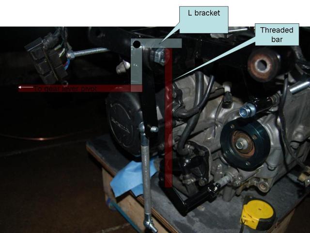

Hi
this is how ours is fitted but may be different to yours since your bracket is on the cradle. I think we have the L shaped bracket the other way
around to you but in your setup it might foul the engine. Perhaps the worx needs a shorter L bracket or selector peg?

Thankjs for the adapted photo.
I had my bracket that way round initially as it was what seemed right, it was only my mate Desperation that turned it this way in the photo!
the problem either way round, as I said above, is the fact that the Ali rose jointed ends both point the same way, and as I am going across a 90
