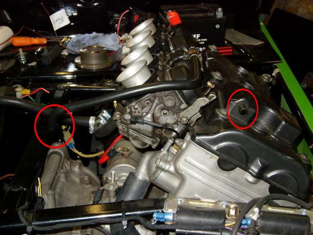

Where do these bits go?
As per the title really.
Its an 893 Blade engine and I'm wondering what to connect the top hose from the carbs too and also what connects to the pipe coming off the cam cover?
Thanks in advance.
Mark.

On mine they are both vented to air.
The cam cover breather has a hose which is tucked away in the bottom of the engine bay and the carb hose is tucked away beneath the carbs.
Nothing ever comes out of them except maybe some fumes. I think on the bike they connected to the airbox.

yep, i think the one out the carbs should go into the air box, and the cam cover can just have a little filter put on it to stop dirt getting in.

Both to air, the cam cover really needs to go into a catch tank with a filter on it, I used a 99p stainless biscuit tin then you are good for track days.
The carb overflow just hangs down where it falls.
