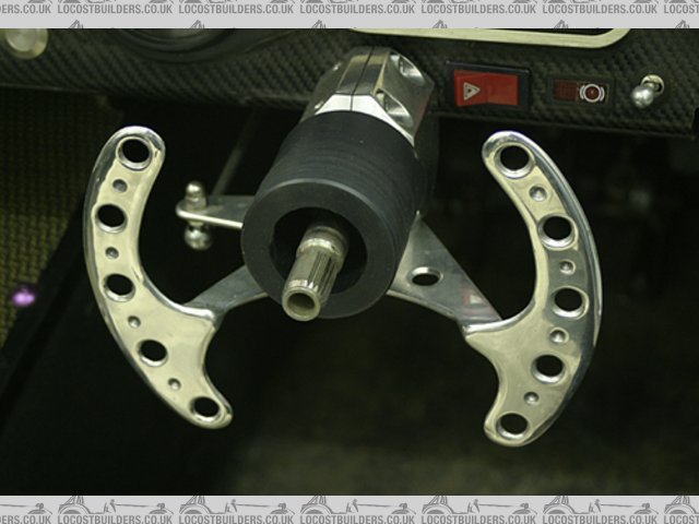

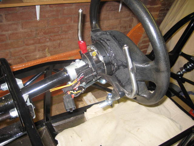

welderman
| posted on 13/11/08 at 08:14 PM |
the top pic is of mine, not yet fitted (made it myself, but not polished it yet)
The Second pic is of Worx's (there are a couple more pics on http://p4nts.co.uk/mallory and he made his himself too)
  paddle
Thank's, Joe
I don't stalk people

andyw7de
| posted on 13/11/08 at 10:21 PM |
What about one of these ?.jpg)

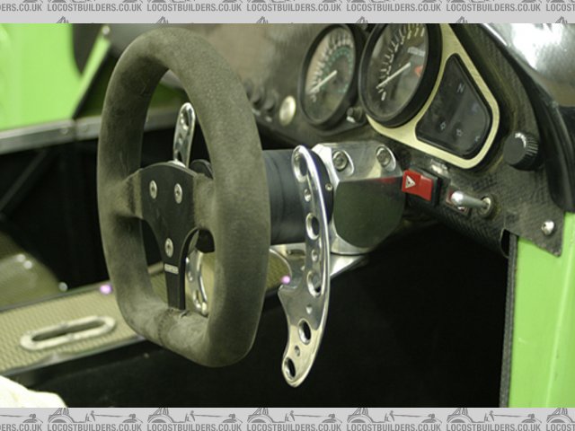

Gergely
| posted on 14/11/08 at 09:12 AM |
We have the MNR supplied one in steel.
I thought it would be heavier than the pretty ali ones you see, but apparently many have experienced bent paddles. So whatever you go for, make sure
that it is strong enough. You will be pulling hard on them in the heat of the moment...
Sorry, pic is very old, but you can just about see how it looks...

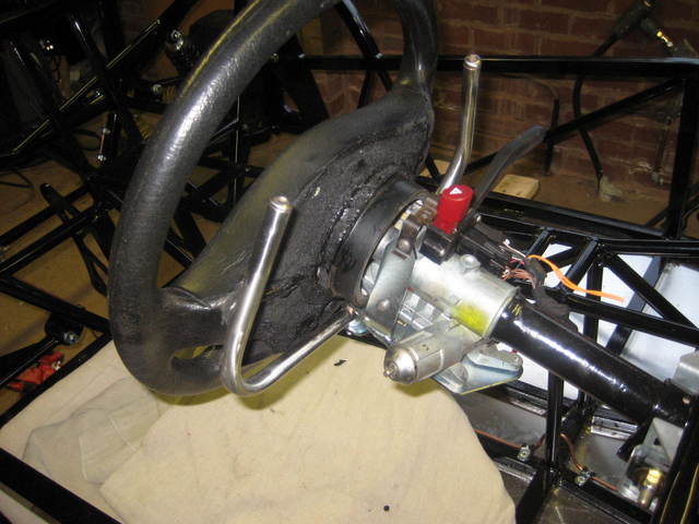

Rob WM
| posted on 14/11/08 at 09:31 AM |
I got these paddles from Dax as they match the handbrake I am fitting. I think they cost £40. I was going to go rods however MK now sell the cables
for about £50 which I wanted to use in the first place.
This is one of the next jobs on the list!!
Rob WM
| posted on 14/11/08 at 09:32 AM |
Here they are from the other side. They allow me to use the orginal switch gear for the indicators etc and I am sure with a little tinker I could use
the other stork for wipers etc.
