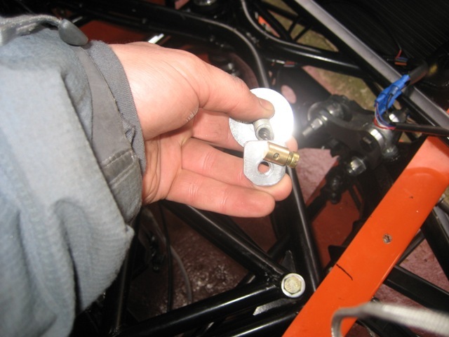

It just so happens i have been dicking about with these in the garage all day today.
Accelerator I have a univeral cable with a nipple pre soldered on the end (TB end) and i have attached the other end with a screw nipple to a bracket
lick the one below
Clutch i have an MNR cable (thick 4mm) which i managed to break the threaded end off so i have just the same bracket/nipple/rosejoint combo i used for
the accelerator pics of the cluch install below
Bracket trial fit on cable:
  Clutchcablebracketoncable
Bracket fit to pedal:
  Clutchcablebracketonpedal
Please ignore the throttle cable in this picture as it is not the actual fit

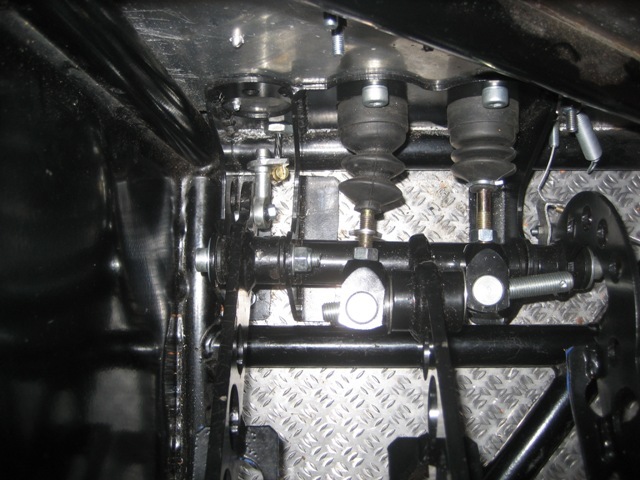

| posted on 17/1/09 at 11:00 PM |
Mine...
