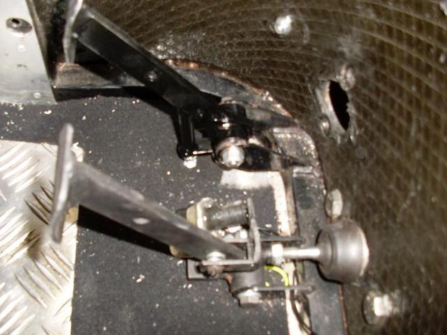

This is our setup - on the build diary it's around November/December 2003 - the setup is the same for our first blade engine as the ZX12R. I
know it's a picture of the Accelerator but it's the same as the Clutch but the Clutch has a thicker wire.

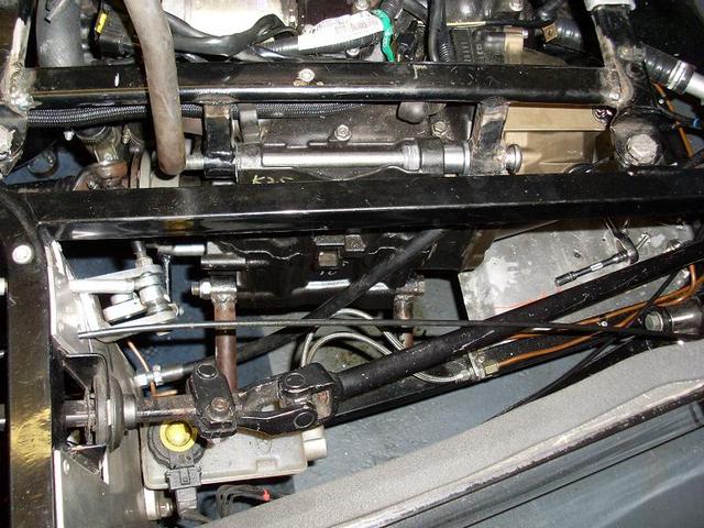

i tried to reuse my cbr1000F hydraulic system but failed after a few goes. So i went for the cable route.
Hope i get the pictures to show up here, but if not look in my archive under ZX12R.
I rewelded the clutch arm on the gearbox 90 degrees out so i got a straight route to the pedal area, seemed silly having a cable running all over the
engine bay when i could have a nice straight (ish) route. Then i cut up a renault 5 turbo clutch cable i had handy and as they are really heavy duty
im hoping its going to last. Then i made a diy adjuster out of an m12 bolt and so the cable sat in it and let me dial any slack out of the cable. Then
used some bolt on nipples on the pedal end. i also modded the pedal so it was like the brake one so it rested on the floor and didnt flop about.
Here goes:
  diy clutch cable adjuster
  cable mount
  cable route
  clutch pedal stop
all seems to work but even with uprated clutch springs the pedal is very light (which i dont like).
