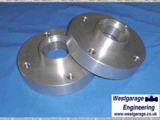

  mx5 sprocket
To keep the oil from exiting the output shafts I have made bearing carriers which use sealed bearings and an oil seal.
  mx5 bearing carriers

orton1966
| posted on 22/4/09 at 08:27 PM |
Liking the look of that a lot!
Liking the look of that a lot! How much for a pair of those baring carriers and bearings?
