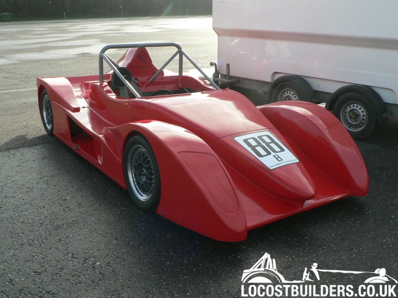

New AB Performance Sabre
Finally after a gruelling 48hr round the clock body fitting session the new car went for its first test at Brands on Friday.
Initial reports from driver were really encouraging - loads of front end grip, good firm steering with plenty of driver feedback and smooth power delivery.
We now have 2 more test days to dial the car right in and then run it in the remaining 10 rounds of the RGB series
It is almost 2 years since I embarked on the project and it was an incredible feeling seeing it lap Brands for the first time, still lots to do but it looks like we will have it on a stand at Stoneleigh, thought you guys and girls might like to be among the first to see it at its first run out, I will post some more shortly.

posted on 27/3/10 at 10:21 AM Reply With Quote
I like that, especially the front end/nose.
What engine are you using?

Andy B
posted on 27/3/10 at 10:38 AM Reply With Quote
this one has been built as a class B car so is running a CBR1000rr 07 engine but we have had ZX12, ZX14 and a number of different 1000s in the back.
Drive is chain through quaife QDF7 lsd and electric reverse at gearbox output shaft. It weighed in at 575kg with driver in and the bodywork is 1st pull so way too heavy at the mo
This one still needs the front light pods, covers, air intakes ang graphics fitting which is happening this week
regards

Andy, My first impressions it looks stunning
Next thought this is exactly the sort of car ive been waiting for as my next project! is it aimed purely for track use or road and track??

Andy B
posted on 27/3/10 at 10:59 AM Reply With Quote
Hi Dave
initially the primary aim was to produce an out and out race / trackday weapon, however the car runs electric reverse, provision for cartridge cat, and has the lights in the appropriate positions so I guess at the back of my mind was the thought that at some point it would be put on the road, ground clearance is the RGB regulation 75mm so not super low (although it can run 35mm) ride will be quite hard as it is all rose jointed but on track the driver reported it was real smooth.
Best bet is to have a look at it in the flesh really and then you can see what makes it tick

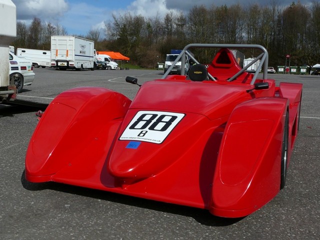

more pictures
A few more from Friday

franky
posted on 27/3/10 at 12:23 PM Reply With Quote
looks nice, Looks like effort went into the bodywork instead of following the common designs that are around. What sort of weight will it get down to without a drive but ready to run?

Andy B
posted on 27/3/10 at 01:07 PM Reply With Quote
Weight of the finished car before fitting the lunatic behind the wheel was 490kg but we beefed the body as it was the first pull from the moulds, I think realistically we cah shed a minimum of 20kg more from the body.

posted on 27/3/10 at 02:13 PM Reply With Quote
Ohh, I like that!!
If/when I sell my Indy, I will now be torn between your Sabre and a Fury. It looks very cohesive as a design too, which many of the similar cars lack a little, IMO.
Also, will it fit two seats, or is it more a 1.5 seater?

Andy B
posted on 27/3/10 at 02:43 PM Reply With Quote
Hi
it is a 2 seater but it is tight, options will be RHD, LHD or central driving position.
