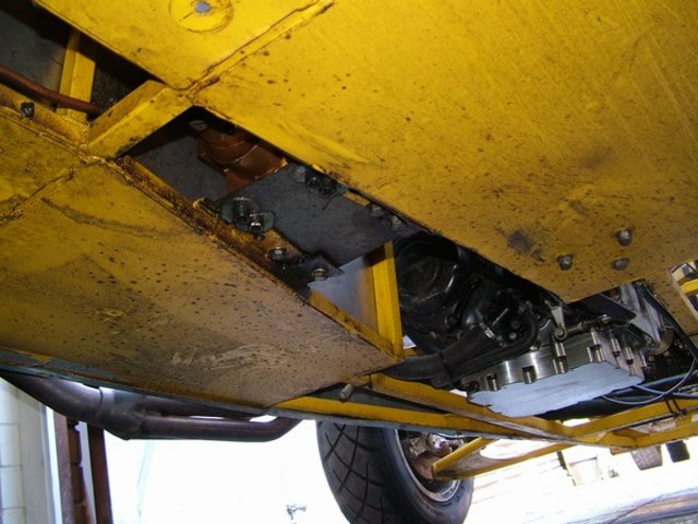

Boggle, here's a few pics of a Blade motor in a Stuart Taylor chassis.
The prop here runs straight but I was looking at one of the MK chassis' at stoney
and that had the engine parallel with the front chassis rail and the prop at an angle.
Not a bad idea as it avoids the front being so close to the top rail.
  Blade install 3
  Blade install1
  Blade install 2
[Edited on 5/5/10 by NigeEss]

boggle
| posted on 5/5/10 at 11:30 AM |
at the mo it looks something like this
u2u me for details
