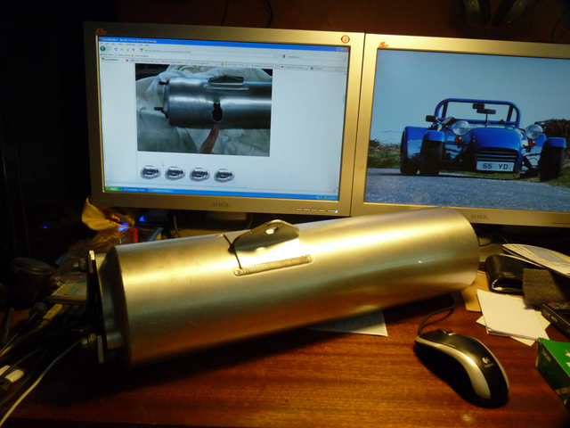

I was just about to fit one to my 2.0 Pinto, should I reconsider? Rescued attachment P1010644.JPG

The issue is with enclosed cars (Phoenix, fury etc) not a problem for 7s
lococost
posted on 15/5/10 at 08:53 PM Reply With Quote
is that a gsxr exhaust? If it is, there are versions that have a cat build in at the front, bound to get very hot!
