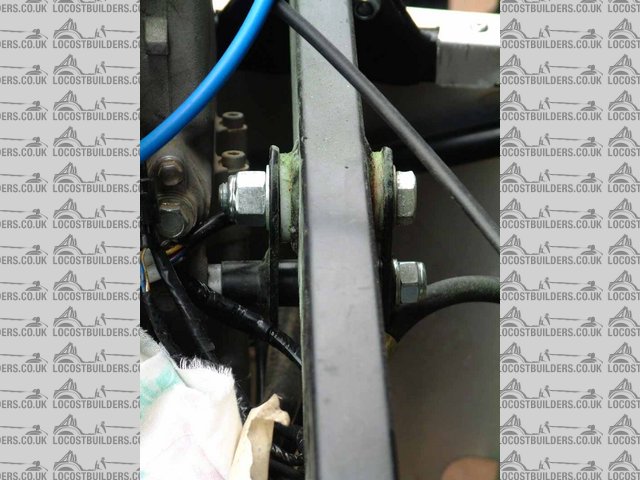

jacko
| posted on 18/10/10 at 04:51 PM |
What about something like this photo out of Wadders archive + more to see
  top engine mount

Johneturbo
| posted on 18/10/10 at 09:53 PM |
I'd like to know what that is between cradle/frame
is that metalastik?
hope wadders doesn't mind me posting the pic
  engine brkt 2
