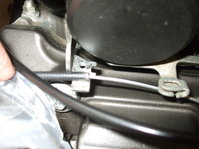

Ok got my self a mini pull and twist choke cable but I still need that little clamp thingy to hold the cable in place!!! Has any one got one I can buy or advise on how to hold the outer cable with out preventing the inner cable from moving???

Nope.... I will try my luck at taking a photo and adding an arrow to where the problem is...

fullpint
posted on 11/12/11 at 12:14 PM Reply With Quote
Not sure if you guys can make out what Im asking for!!
Can you see the little thread? I need the part that goes here. Ok the screw I expect I can find one..

Andy B
posted on 11/12/11 at 12:42 PM Reply With Quote
Got the bit you need here, send me an address and I will send you the clamp
