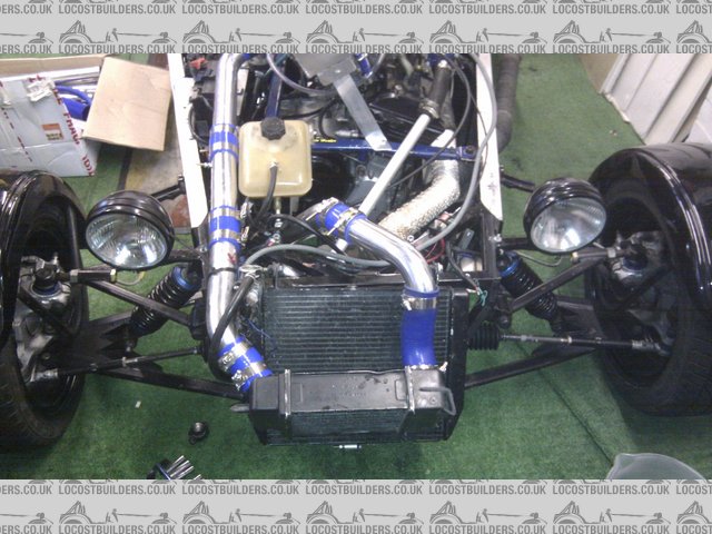

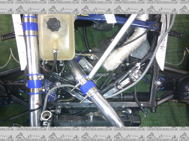

I've attched photos of my set up with a graph from the rolling road in my archive
My inlet manifold is 4 inlet pipes into one 2" pipe running to the turbo
My exhaust is 2 1/4 " bore with no major bends
The turbo is actually a TE15 turbo from a Saab 9000 equivalent to a T3
My boost is controlled my a gizzmo, it peak @ 13 psi then drops & holds @ 9.1 psi

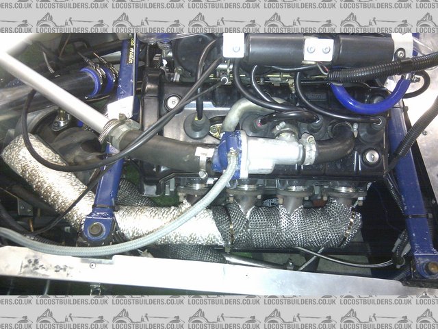

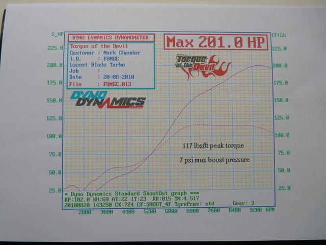

mark chandler
| posted on 22/12/11 at 04:56 PM |
Lovely tidy build, congratulations
To put pictures in the page copy the URL at the top when viewing.
To look in other peoples archives click on the links under there avatar's.
For me the exhaust looks to be a culprit, it is a log manifold which is not great but taking all the gases out the chambers, slamming them into a 90
degree bend then moving onwards with sharp another 90 degree bend will create issues.

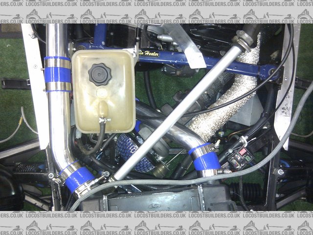

Mine is okay, knocked up from an old stainlees bike manifold so a bit ugly:
  plenum 1
Welderman's is the way to go:
  headders and turbo on bench
The biggest issue is heat, you will be throwing a huge amount of heat straight back into the induction system from the position of the turbo.
The intercooler must be in front of the rad, I read somewhere that 10 degrees of addtional heat can cost as much as 10% of power, when I log mine the
inlet tempretures drop when I go on boost, yours is doing the opposite and adding heat not extracting!
Even if you leave everything as is, insulate the inlet tubes and put baffles in to seperate the turbo from engine as much as possible, duct the
intercooler so not rad air can hit it and extend the air filter so it gets air from in front of everything else or stick it outside the body.
Here's my graph BTW, much less boost on a smaller engine that is completely standard apart from EFI and clutch.
and air ducting that sits under the nose cone
  intercooler
First job is move the intercooler and air inlet, high temps = holes in pistons.
Regards Mark
[Edited on 22/12/11 by mark chandler]

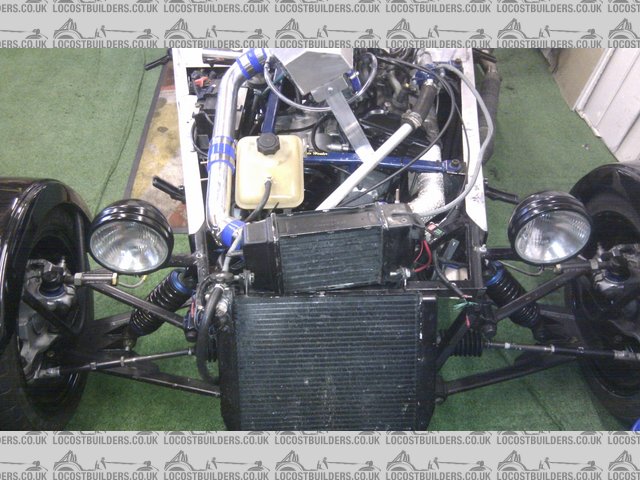

macboycie
| posted on 22/12/11 at 07:57 PM |
Thanks for the input
I will move my air filter & get the intercooler in front of the rad
I'll wait until next year to get a tubular manifold made but for now its a good starting point.

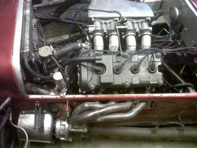

INDY BIRD
| posted on 23/12/11 at 09:48 AM |
Pic of my zx10 turbo kit,
Before install,
[Edited on 23/12/11 by INDY BIRD]
crafty
| posted on 23/12/11 at 09:58 AM |
^^^ Yep... just like that... nice short primaries.

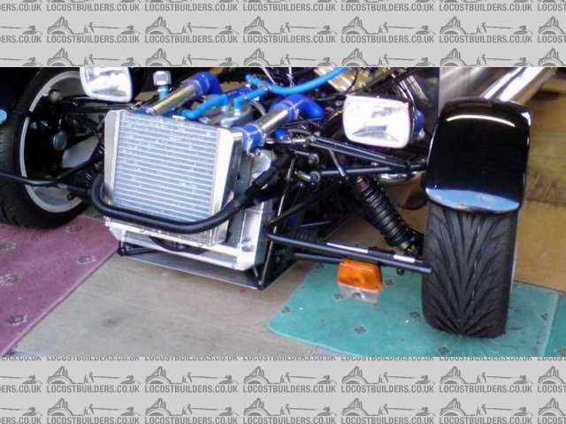

macboycie
| posted on 23/12/11 at 03:27 PM |
Photos of what i've done today
INDY BIRD
| posted on 23/12/11 at 03:37 PM |
I found when mounting the intercooler in front the car got hot on track so put a cossie 2wd intercoole on top and worked a treat and good for easy
300bhp,
Pic
Another install I did was on the dax, also changed due to heat on the rad side got to hot on boost went for on top intercooler as above pic,

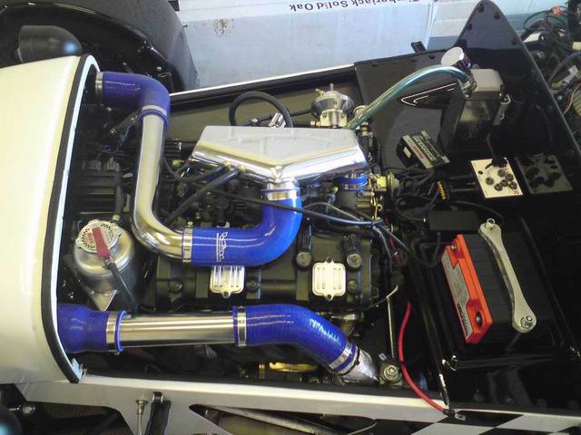

SausageArm
| posted on 23/12/11 at 04:36 PM |
Here's my ZX10R engine before it went in the car
and in the car
Intercooler, oil cooler, radiator up front
I found it ran a bit on the hot side so decided to fit additional cooling in the form of a 12v electric water pump feeding a second radiator mounted
in the boot
all discreet again
