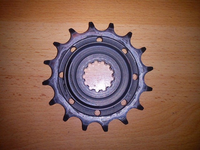

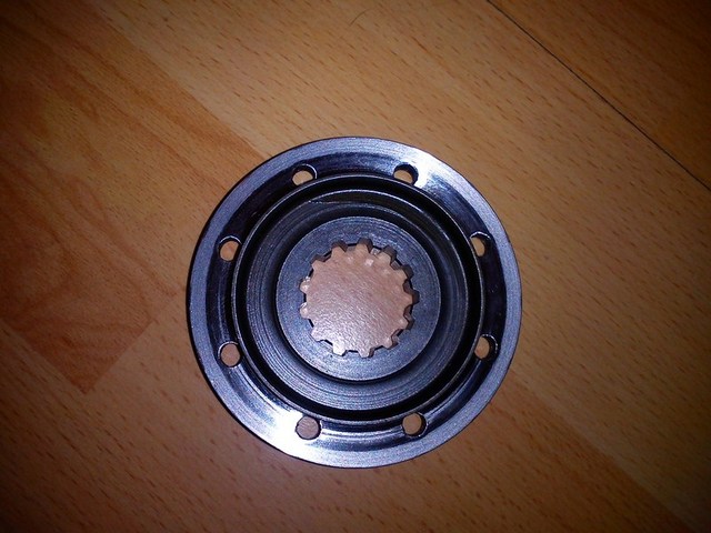

Last progress...
From this:
  ZX9R sprocket before
To this:
  ZX9R sprocket after
Now I need flange/adaptor to fit my sprocket...

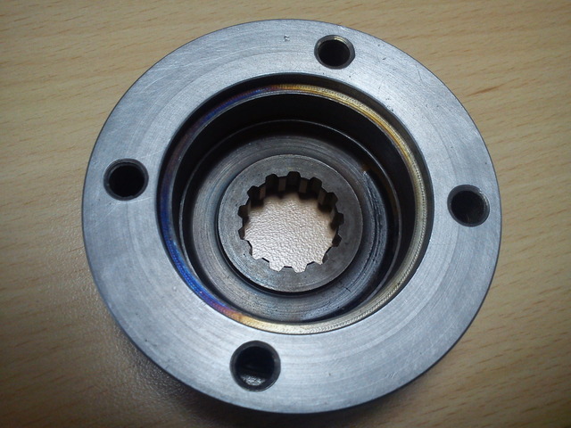

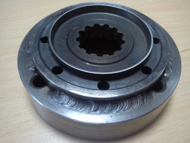

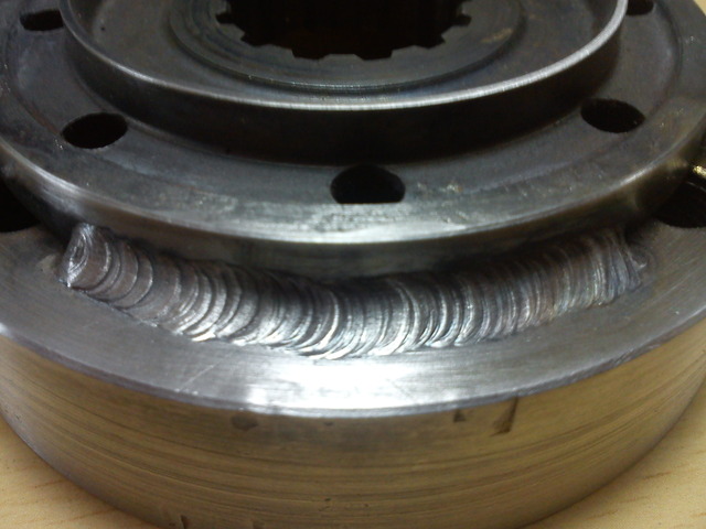

| posted on 17/1/13 at 04:21 PM |
Update...
Here's final result: SAE1140 DIY sprocket adaptor
  Ready
  TIG welded
Total (lo)cost: 22GBP
Lucas
