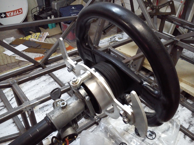

loony
| posted on 4/10/15 at 07:37 AM |
I fitted mine in place of indicator stalks.
DIY using Solidworks and steel laser cutter
  paddle shifter

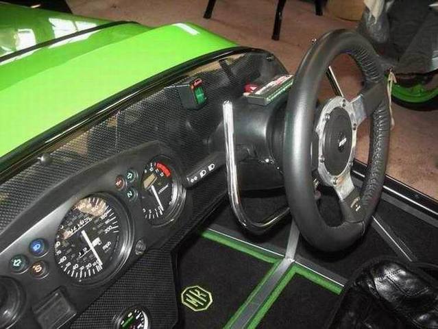

INDY BIRD
| posted on 4/10/15 at 08:04 AM |
i did this 10 years ago
greavesy7
| posted on 4/10/15 at 12:27 PM |
Nice work
It's somthing I wanted to try and make my self.
How do you go about your indicators ? Just move onto dash ?
INDY BIRD
| posted on 4/10/15 at 12:33 PM |
they stayed in place see pic,
but i heated up the plastic arm to bend it a little way from the paddle, etc all worked spot on

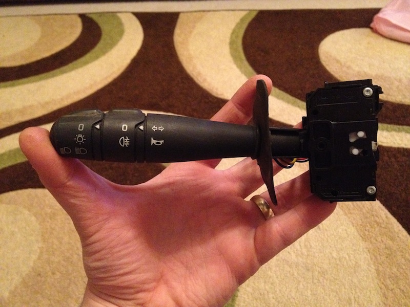

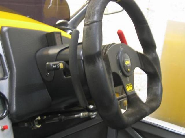

loony
| posted on 4/10/15 at 09:28 PM |
As for my paddle shifters and stalks, I will use Clio mk2 indicator stalk near the dashboard (all light in one place - main, dip indicator, fog and
even horn) - just like "yellowcab" - picture from his topic:
[Edited on 4/10/15 by loony]

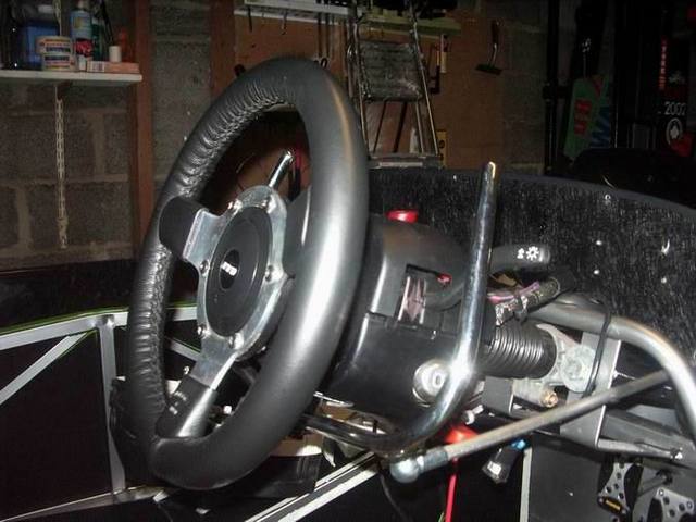

Hellfire
| posted on 5/10/15 at 05:52 PM |
Here's a few photographs of our paddle shift which retains the Sierra switch gear.
Phil
  Paddleshift 1
  Paddleshift 2
greavesy7
| posted on 5/10/15 at 09:54 PM |
Has anybody got a picture of the connection with the sierra stalks please ?
